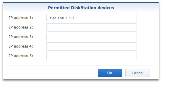

I did get this working by installing the NUT (Network UPS Tools) plugin as mentioned by @casperse configuring the UPS Mode (Settings > NUT) to be a "Slave" and setting the UPS IP Address to the Synology NAS (no port number required) - I left all other values as default and started the UPS Tools Service.
On the Synology NAS I simply entered the IP Address of the unRAID box in the Permitted DiskStation devices and checked the "Enable network UPS server" in the UPS tab of the Hardware & Power Control Panel.
The NUT plugin displayed all the settings from the UPS and seems to be up and running just fine :)

Pulling this thread put to the surface just to remind the next person looking for this.  After you add your Unraid server's IP address into the "Permitted Synology NAS Devices"   Make sure you hit "Apply" on the bottom right. The changes will not go through until you do.
Sounds obvious looking back but I just spent 30 minutes trying to figure out why it wouldn't work.  Finally I decided to was gonna restart my synology and it asked if I wanted to save when I tried closing Control Panel.  Worked great after I hit Apply haha
I also used JUST the IP address, no port needed.
