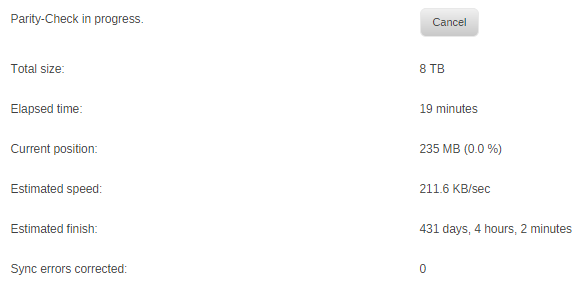

Benson, thanks for the suggestion. I've started a parity check: it's S..L..O..W: I'm getting a speed of around 210KB/s (see attachment Parity_check.png). This compares with my parity check one month ago where the speed was 285 MB/s (see attachment Parity_check_previous.png). Now, I must admit I don't believe the previous speed, but it got me to thinking about my dual parity.
(Just saw the RFS question: no, I'm using XFS on all data drives, and no single drive has less than 140GB free.)
I've been running dual parity drives for a while, both 4TB. Shortly before the previous parity check, I changed one of the parity drives to an 8TB drive, and I'm reasonably sure the recent parity check was after the new parity drive was installed. So possibly the parity speed calculation was actually using 8TB when in fact there was only 4TB of parity being checked. (And the screenshot for the current parity check shows that Total size to be 8TB.) So "real" speed was perhaps half, which is still not bad, but more realistic.
So I'm wondering whether there's a problem caused by having two different sized parity drives. Is unRAID trying to do something extra because of the different sizes?
I'm leaving the parity check running for now because I can't think of what else to do.

There's multiple read write activity on some disks during the parity check, so the speed will me severely impacted, that's normal.
OK, I thought parity checking involved only reading data and checking that against the parity. But in any case I realised that the read/write stats are cumulative; after clearing the level of activity is much lower.
But surely something is wrong with my setup. I'm 9 hours and 7 GB into parity checking, average speed is 226KB/s and estimated finish is in 402 days' time!
At the time the diags you-re saved there was heavy activity on disks 2, 3 and 5, stop that and after a minute parity check speed should return to a normal +100MB/s plus speed.
That makes sense. Is there a way of seeing what's causing all the activity? Using a top command and also looking at the Open Files plugin, it seems that most of the ongoing processes are sha256sum - and yes, there are files on at least disks 2 and 5. That might be related to the Dynamix File Integrity plug-in, but it's set to not start anything while parity-checking is going on. Perhaps these are slowly completing (but 9 hours!).
It's almost certainly that, cancel the check and wait for the checksums to finish or disable the plugin.
Thanks so much!
It was indeed the File Integrity plug-in! I tried various ways to suspend the plug-in and also tried killing the various sha256sum processes, but new ones kept on popping up. In the end I removed the plug-in and bingo! Speed immediately up and now at about 40MB/s.
