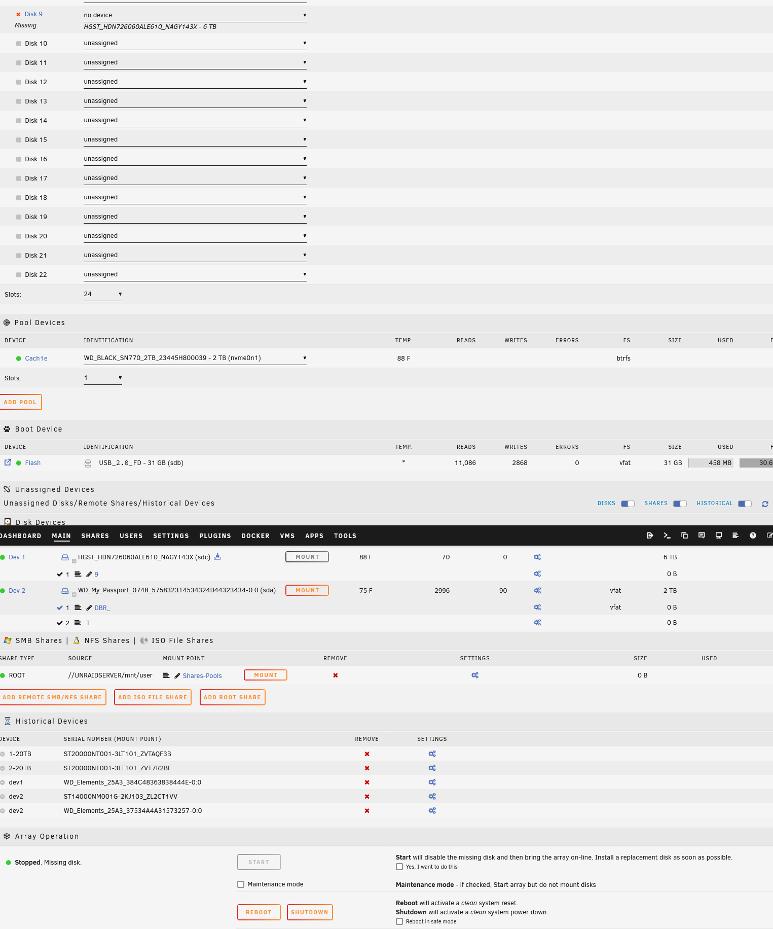

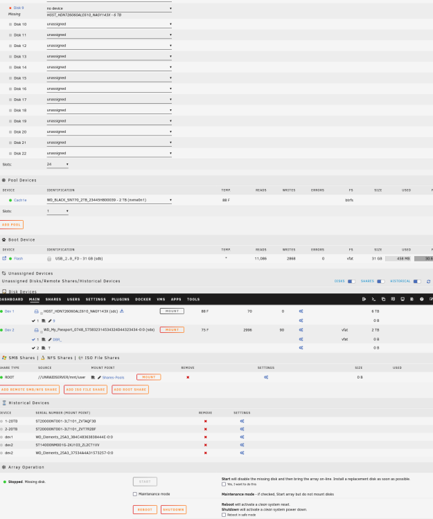

Not sure why my per-cleared disk showed it was "unformatted and unmountable" in my disk array, this is when I disabled the drive and got to the screen (image below).  This is where I went down the rabbit hole.
On 1/31/2024 at 4:46 PM, Aidan13 said:
I see their is a check box next to the start array button (i think called) "deselect drive from array"
Actual text was "Start will disable the missing disk and then bring the array on-line. Install a replacement disk as soon as possible."
Because that's how it's supposed to be since it's cleared, you then just need to format it within the array.
