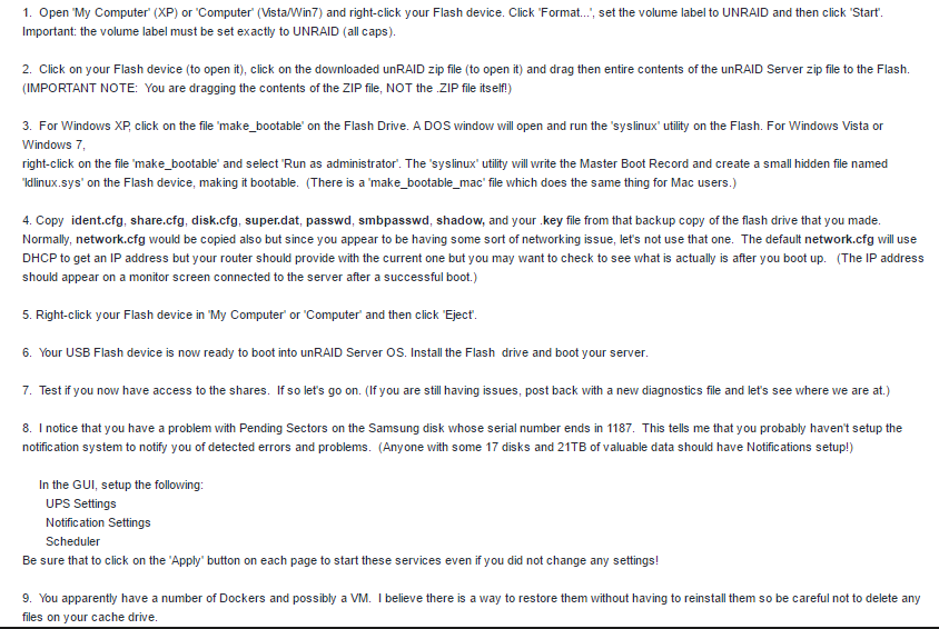

What's weird about unraid not detecting the physical connection is I could still access the web interface... strange. I've since followed this: 594e51723fd2b_Resetunraidhere.PNG.35454846c6db9af5dbf9d4487e657826.PNG
From another thread which has solved my problems. I'm thinking a rogue plugin (or something outdated) caused this issue or I did something, not sure what...
