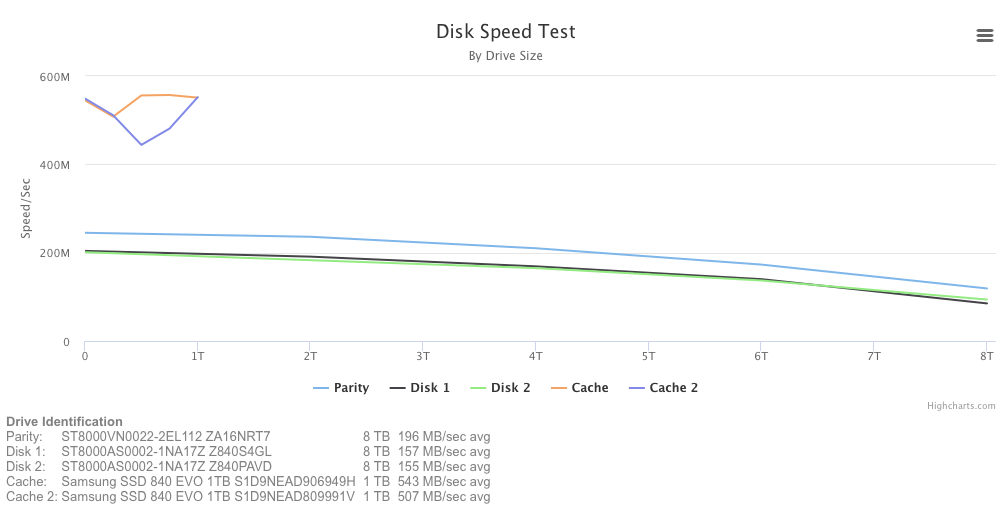

Ah... good to know.  thanks.  I ran a quick Disk Speed Test and I'm happy with how things are... was running a couple VMs at the same time the test was running... it does look like the Seagate Ironwolf drive (used for my parity drive) does indeed perform better than the Seagate Archive drives, which I anticipated.
