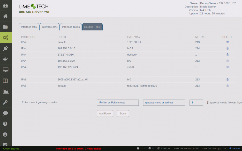

Here is my network routing table:
The IPV6 address is my default gateway.  Is this a router and/or ISP problem?

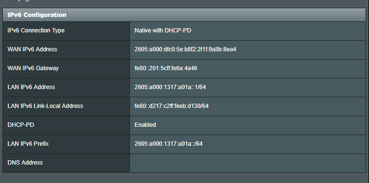

More information.  The IPV6 address is the link-local address of my router:
Looks like your router disappears once a while from the local network.
I am a bit puzzled about your WAN and LAN addresses. You have enabled prefix-delegation (PD) which should let the router create LAN prefixes under the WAN prefix.
Your WAN prefix is 2605:a000:dfc0:5e/56 (I assume /56 but actually ISPs may use different sizes)
Your LAN prefix is 2605:a000:1317:a01a/64, which doesn't fall within the WAN prefix and if your router doesn't do any routing protocol with the ISP side, it will cause routing issues.
Did your router assign the LAN prefix itself or is this a manual action?
Ps. I do not have these kind of messages
The router assigned the LAN prefix itself.
