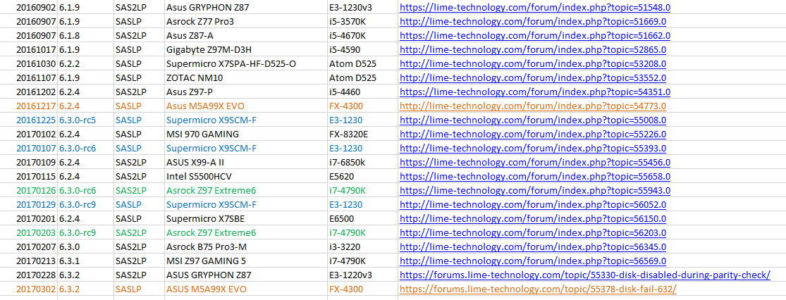

Also: when referring to "Typical SASLP/SAS2LP issue", can you be more specific?
Controller crashes and drops several disks, I was collecting info for a while to try and find why it only happened for some users but gave up as the only thing in common between them were the controllers themselves.
