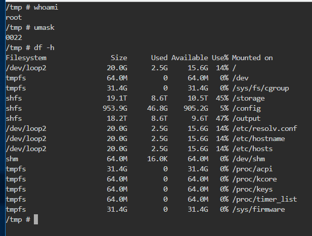

@Djoss quick question. What umask can I use to get files created as 777? I see you have default of 000. What I notice is that when I create rips using makemkv, I cannot delete them from my windows PC over the network, permission denied. It is because the directories (when using backup mode) are being created as 755. When I manually change them to 777 from the OS layer, I can then delete them over windows PC.
EDIT: Is this correct, or are the template umask settings of 000 being ignored?
Edited by cybrnook
A umask of 000 should give permission 777 to folders.
MakeMKV doesn't create files/folders correctly and requires a hack to properly respect the umask.  It seems that this hack doesn't apply to backup mode.  I will fix that.
