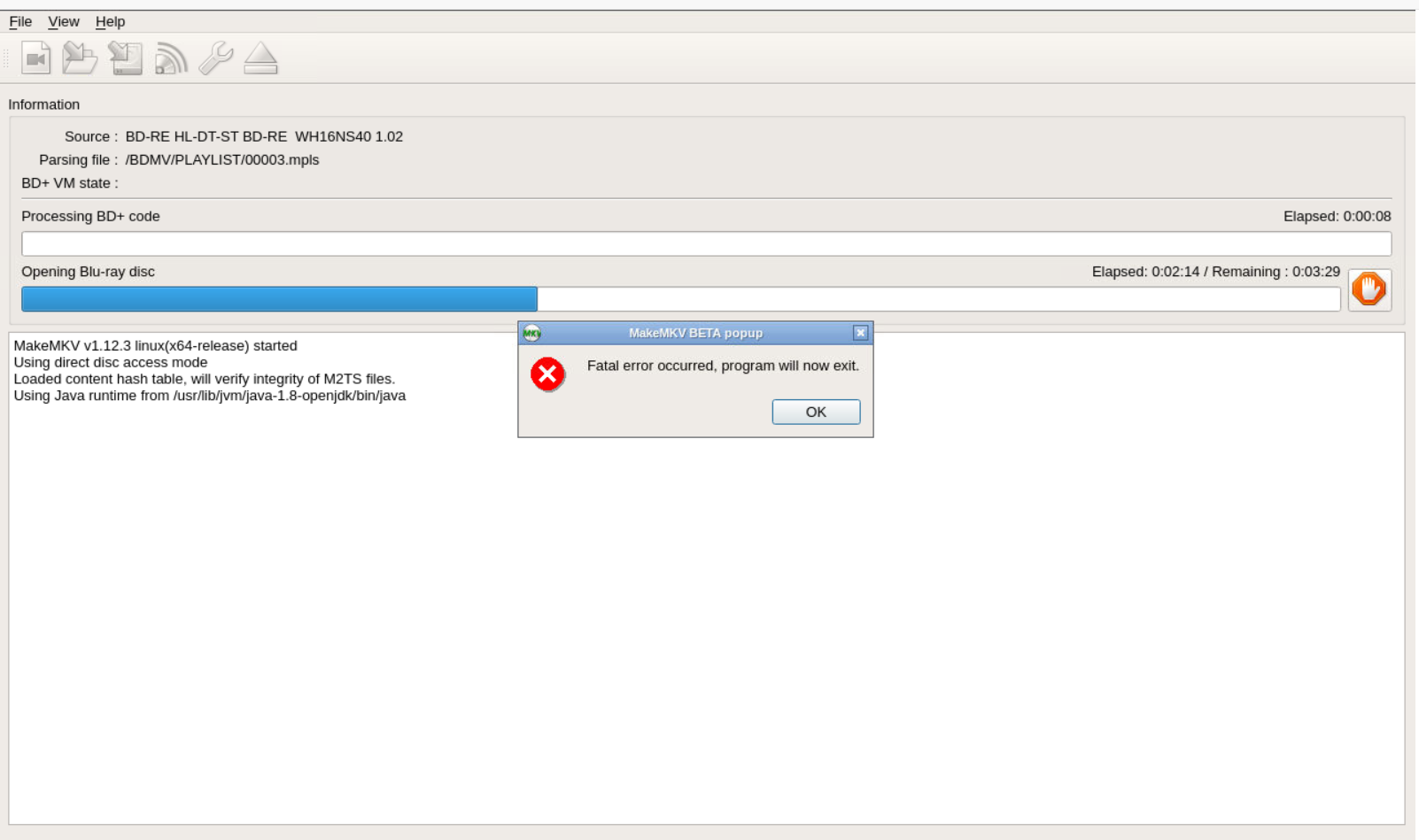

What did the fix end up being for luisv? I am getting the exact error code as him. I tried changing the version and got the same error as well. This is an old ghost rider movie, not a new movie at all so I wonder if its not disc related then.

I think it's an Alpine Linux and Java related issue.
So if I understand correctly, making sure libjli.so is found by java fixes the backup mode, but not the ripping?
That's how it's appearing. And seems that instead of copying, we could fix it by adding more PATH directories as well, though untested.

I'm sill trying to find a BluRay disc requiring Java so I can reproduce myself the issue...
Sicario: Day of the soldado
If you have a movie store near you that rents.
Sorry guys... I was able to backup the disc successfully, then used Handbrake to convert the backup to MKV.
Sure, but there is still a problem. This is a good disc to use to expose it.

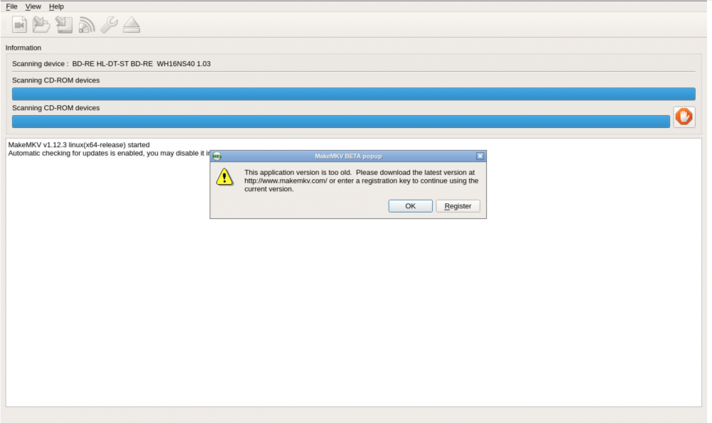

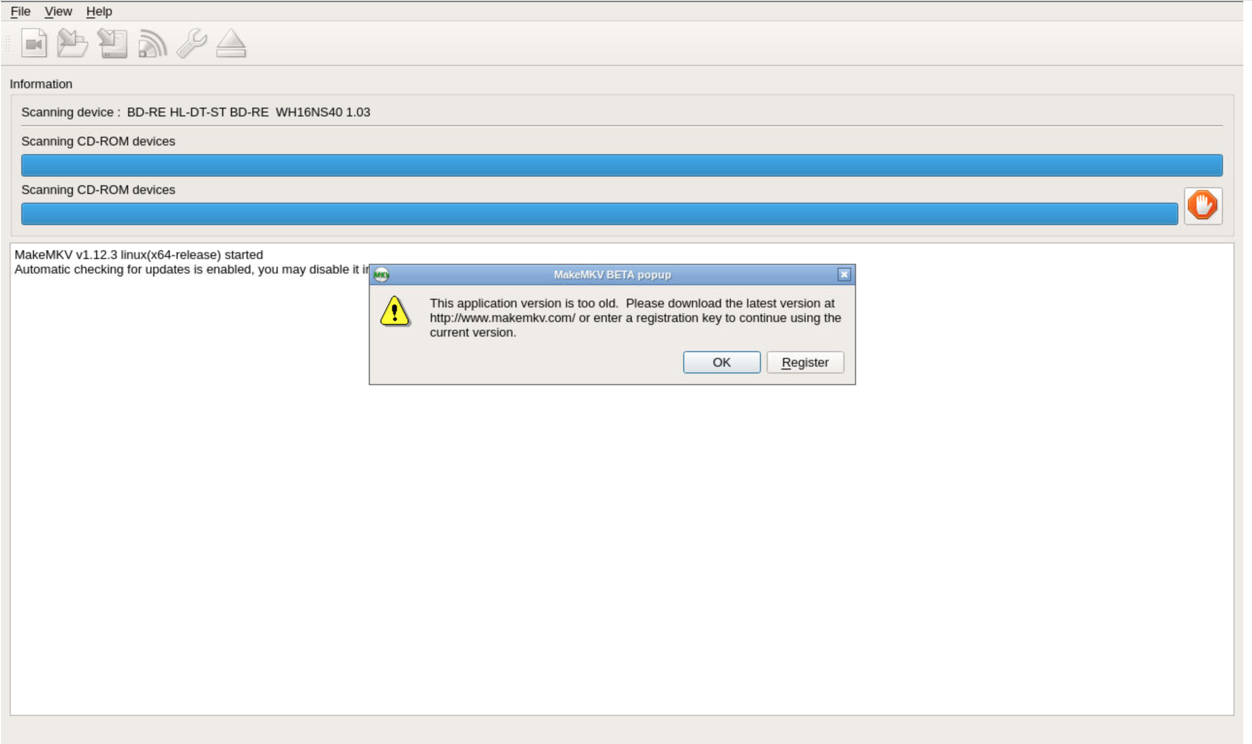

I'm getting this error:

Even if I manually enter the new beta key (valid until November) and also force update the docker container. Any suggestions?
I bought a key and I'm still getting the same error.

Do you set the key via the environment variable?
You can also try to start with an empty appdata folder:
  • Stop the container.
  • Move the appdata folder by executing "mv /mnt/user/appdata/MakeMKV /mnt/user/appdata/MakeMKV.backup"
  • Start the container.

I tried a couple of BD+ BluRay discs that were all decrypted successfully using Java.  I guess that I don't have one with the proper protection.
Which protection has your disc exactly?  MakeMKV displays the protection on the main page, before starting the titles detection by clicking the big drive icon.

Java can be used for other purpose also.  So usage of Java doesn't indicate it's a BD+ disc.  From what I saw, there is a clear indication when the disc is BD+.
But if your discs ripped fine, knowing their protection is not really important.  I'm better interested with protections that produce a crash ;).
