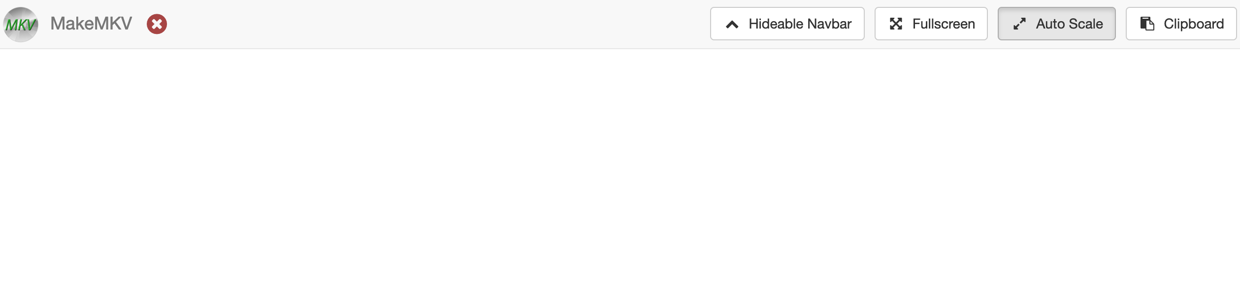

Replaced my LG CH08LS10K with an Asus BW-16D1HT and when I open the webUI, it doesn't open the MakeMKV UI, it's basically blank?  Any help is appreciated.

What's the log say? To the right of the docker in unraid gui.
No errors, no warnings that I see... I just tried the MakeMKV-RDP docker and it worked without issue.   Very odd...
Edited by luisv

On 3/4/2019 at 9:29 PM, Djoss said:
Try to clear your browser's cache...
I've tried that as well as tried a different PC... same issue.
Is the container running or it stopped itself?   Also look at the container's logs.
