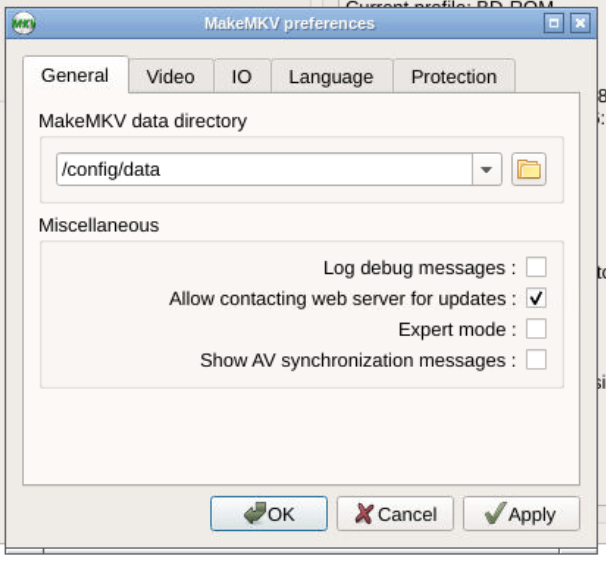

I'm not able to download the SDF file which I believe is preventing me from ripping UHD discs. It says "Automatic SDF downloading is disabled or failed". What can I do to fix this?
In MakeMKV settings, do you have “Allow contacting web server” enabled?
Yes

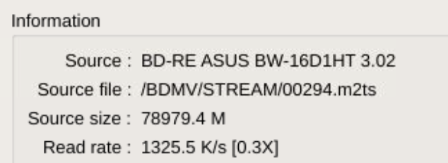

is anyone seeing speed issues? I have it setup and installed, its seeing the disc, but its super slow, I think its showing 9 hours to complete
Did you exposed 2 devices for your reader?  If not, look at the container's log to see which one is missing.

Two devices? I only have the one Bluray Drive, --device=/dev/sr0 is the only thing in Extra Parameters, is there suppose to be a second?

I attached the log, I am still only seeing .3x copy time or less, which results in a 10 hour copy time.
which device am I missing?

The same BluRay drive has 2 linux devices associated to it.  In your log, you can see the following log:
[cont-init.d] 95-check-optical-drive.sh: found optical drive [/dev/sr0, /dev/sg0], group 19.
/dev/sr0 and /dev/sg0 are the 2 devices that normally need to be exposed.  However, the container doesn't complain about any missing devices... are you running the container in privileged mode?
On 1/26/2020 at 9:57 AM, wesman said:
By CC, do you mean the PGS file?
No, CC is a type of track where MakeMKV will try to extract subtitle from the video itself, which can have a significant impact on the extraction speed.
