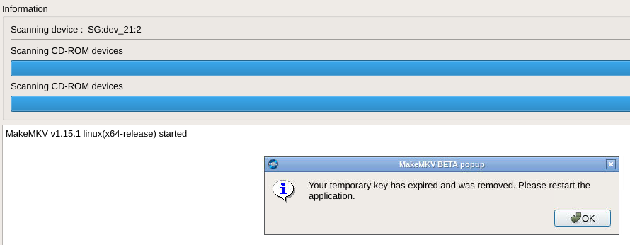

Any ideas on how I can solve this?
@Djoss Would be nice to be able to adjust the container date for cases like this where the beta key hasn't been updated. Luckily I have a "backup" computer with a BD-ROM drive that I can use in a pinch but I'm sure others aren't so lucky.
