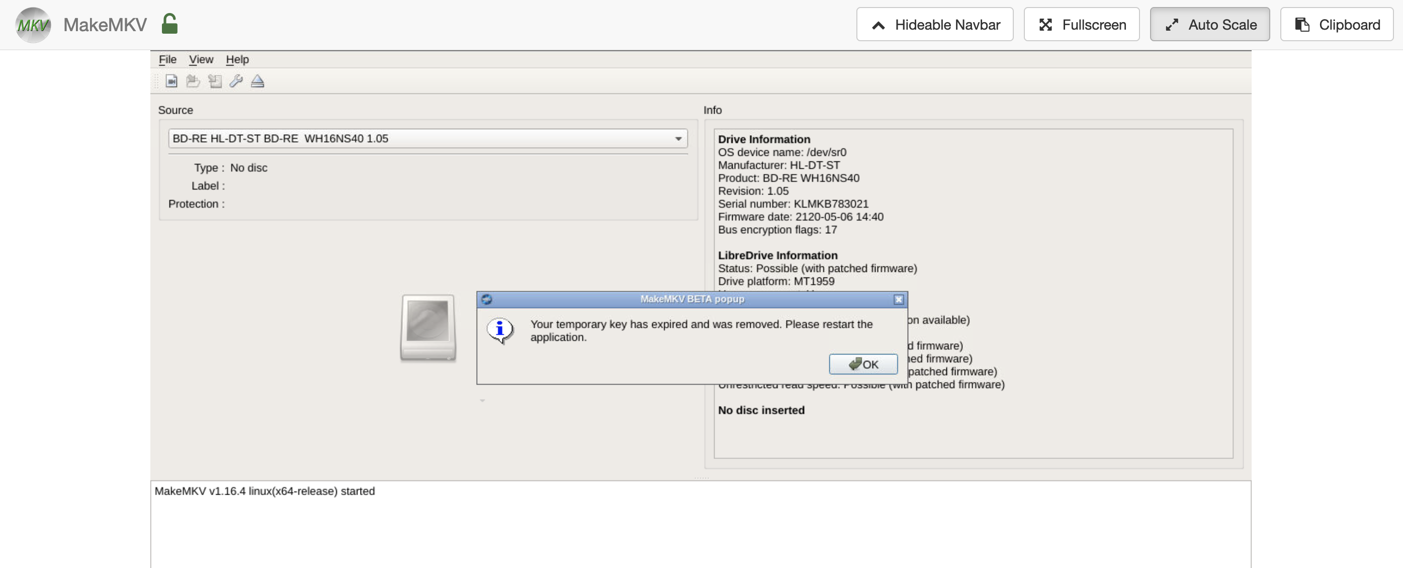

When I went to log into MakeMKV to rip a DVD today I got this error....
562137733_ScreenShot2021-08-01at4_26_22PM.thumb.png.b6bc9325eec138853b44c2ea96865e1d.png
954212951_ScreenShot2021-08-01at4_26_32PM.thumb.png.d7b3485be2f1d0a48db20befdb2d56d7.png
I then went and purchased a code and entered it to register... it accepted the code and asked me to restart the program. I close the tab... and then restarted the docker container. After the restart I get the same error. Not sure what is happening... but no matter when I do I am in this same loop.
I have attacked the log file in case that helps in some way.
Thanks for any help on this!
In the settings of the docker there's a field called "License key".  Put your key there, (or BETA for beta).  There always seems to be a lag at the first of the month, though, in getting the app to recognize the beta key or get the new version.
That did the trick... thanks so much. I feel like such a newb.... ugh!

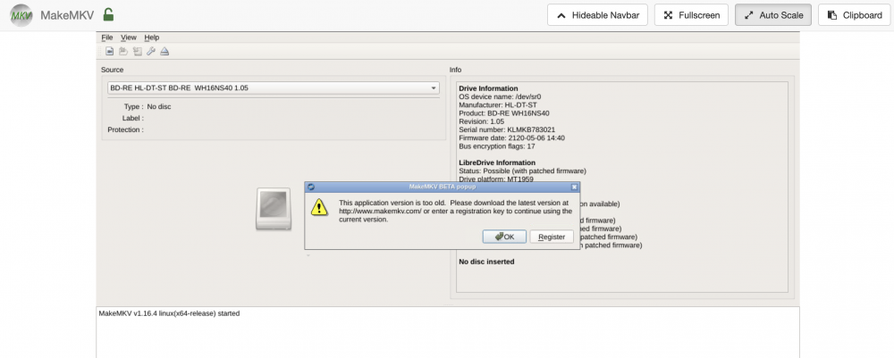

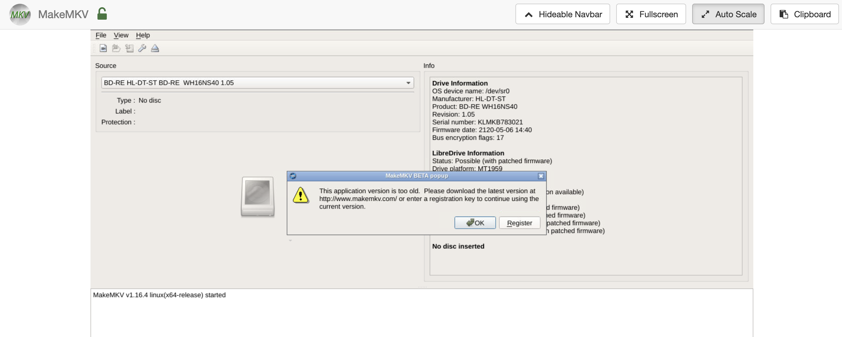

Didn't work for me. I had 'BETA' there, tried entering the key listed in their forum (says expires July), and when I go to WebUI I get the same errors as I've shown before.
Maybe a new key is needed.
Yes, a new key is needed.  It should be published soon.
Once the new key is published on the MakeMKV forum, you just need to restart the container: the key will be fetched automatically.
Just purchase a key and you will not have to worry about it
