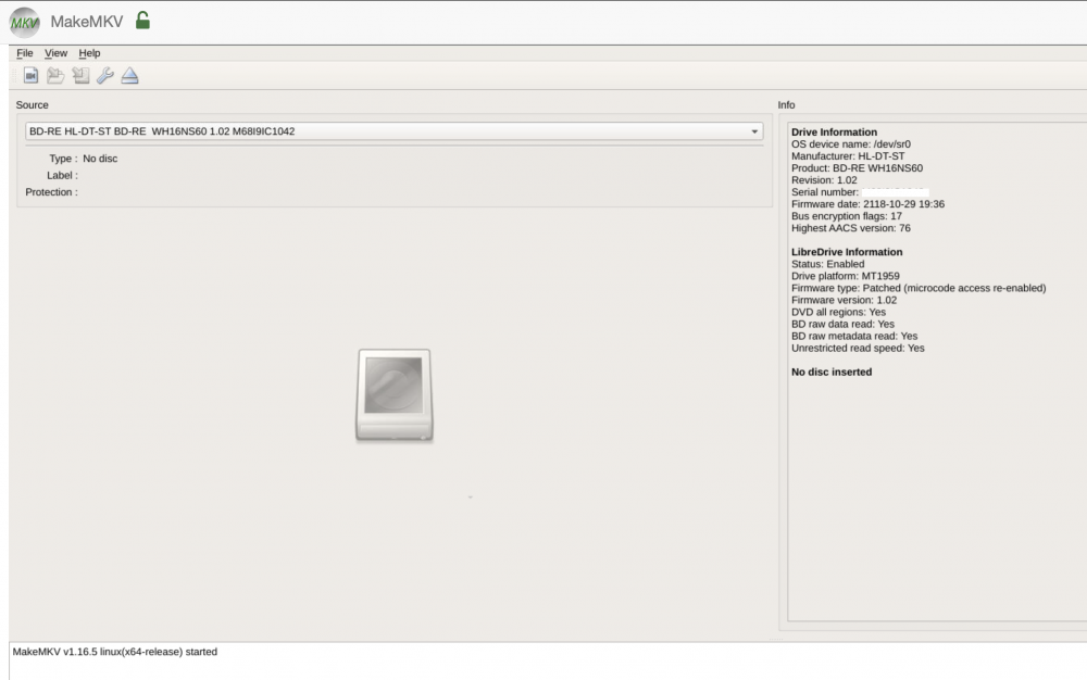

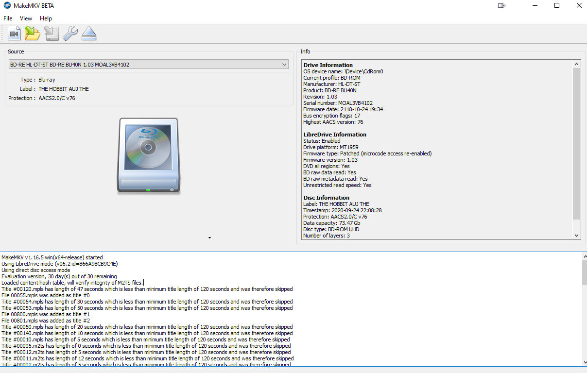

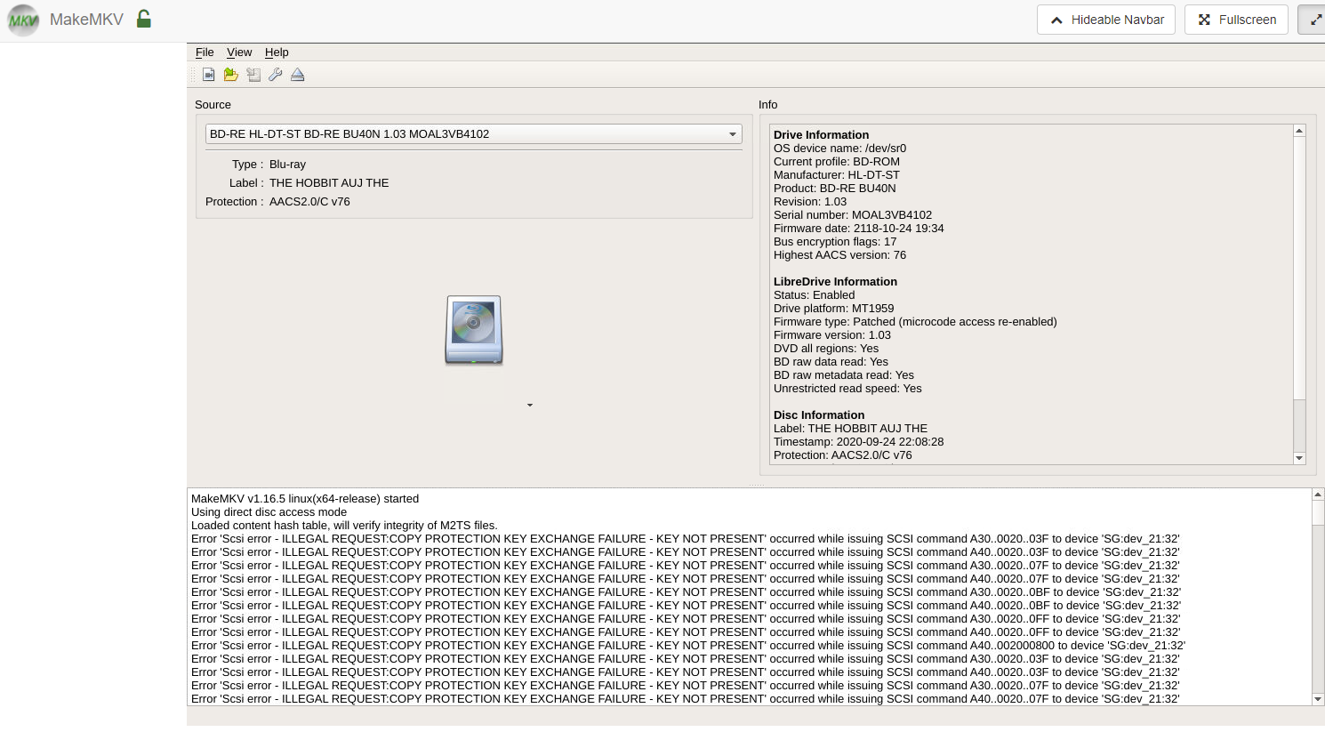

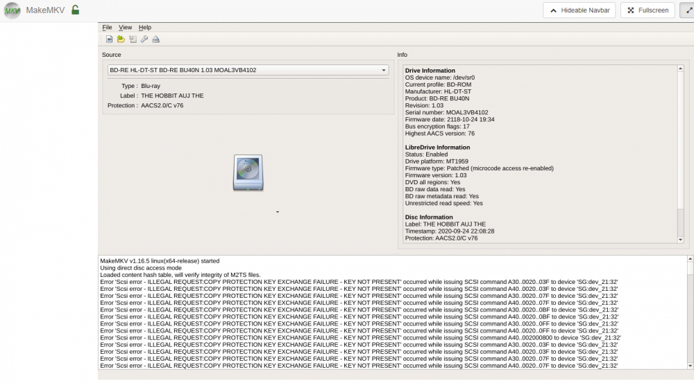

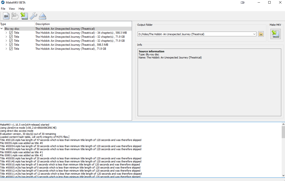

Anyone able to point me down a possible troubleshooting path here.
Trying to open this Blue-ray Disc in this docker in Unraid and it fails loading the disc.
But on my windows machine using the same version of mkmkv and the same usb drive it reads it fine.
I can see the LibreDrive info in both windows (below pics) and linux/unraid docker (above) and both say the same info that its enabled.
But in the output in those screen shots the windows box has
MakeMKV v1.16.5 win(x64-release) started
Using LibreDrive mode (v06.2 id=866A98CB9C4E)
Using direct disc access mode
but in the unraid docker it doesnt seem to use LibreDrive mode
MakeMKV v1.16.5 linux(x64-release) started
Loaded content hash table, will verify integrity of M2TS files.
Error 'Scsi error - ILLEGAL REQUEST: COPY PROTECTION KEY EXCHANGE FAILURE
Regarding my post above my only guess at the moment is that the container for some reason doesn't have access to the internet to download packages etc as it needs.
No, you need to pass the sr0 and the sgX parameter for full access in linux
after you start the container look at the log for makemkv it will tell you what to pass

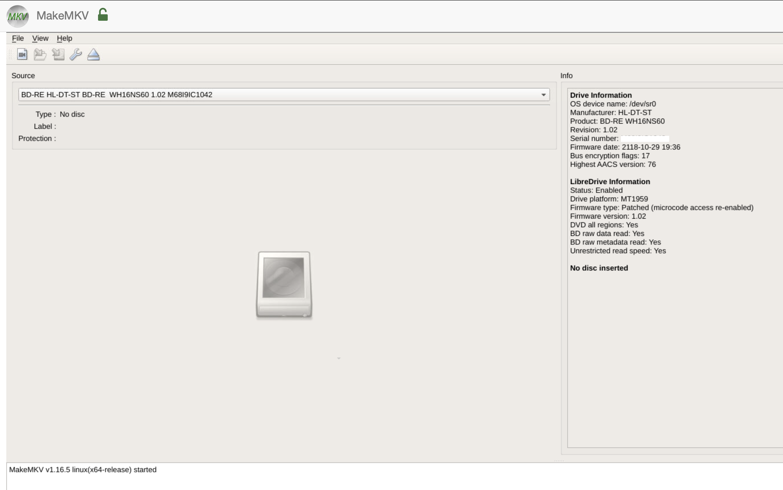

Hey guys,
I’ve been using this for quite a while now and totally love it. But occasionally I get reading errors or “no Disc” errors. Rebooting the server helps whereas rebooting the docker does not. Is there any way to fix that without rebooting the server? Maybe some CLI command to power cycle the drive or something like that? Would be awesome!
I have a huge issue with the docker atm...
It doesn't list the drives like before in the log and I can't use it with any drive/ any sata usb adapter.
I don't know why, maybe there's a issue with the 1.6.5 version. It did work without any problems before.
I did try the sg_map command, but it doesn't show me anything useful (to me).
Any idea what might be the problem? I'm not sure where to start looking, even a restart, other usb port, other drive brand etc didn't change anything...
