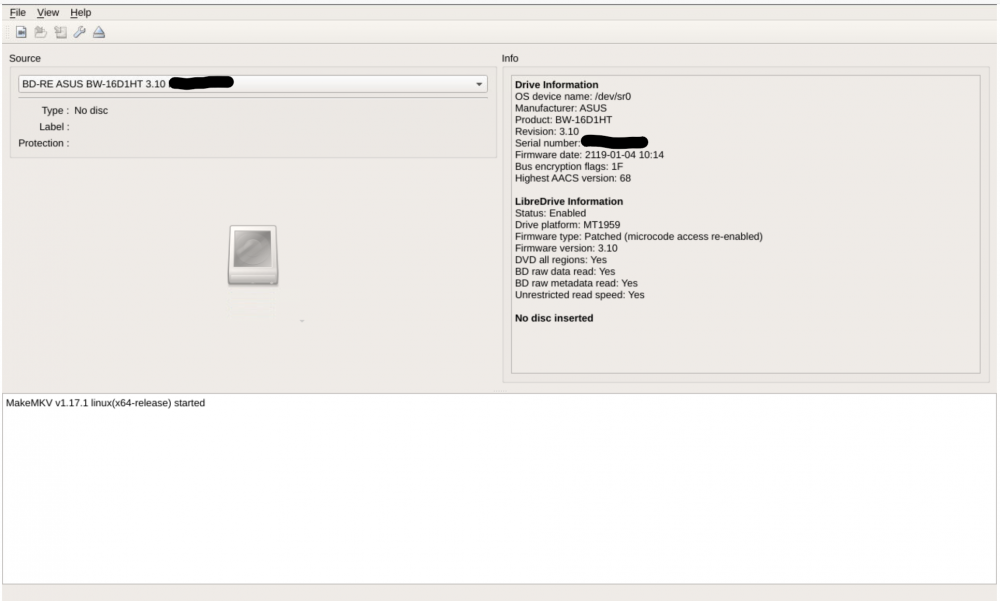

Been having the same issues as other posters above but cannot find a solution.
Previously working Asus BW-16D1HT drive no can no longer load BluRay or UHD disks, including those that have worked previously. I'm met with this screen on the GUI after the drive spends several minutes attempting to load.
Container has been removed and reinstalled and device names have been confirmed in console. No success. Is this a licence key issue?
Did you try an older version of the image to see if it's working again ?
Also, were you using the latest version of the image ?  Looks like a similar problem has been resolved with the latest version of MakeMKV:
