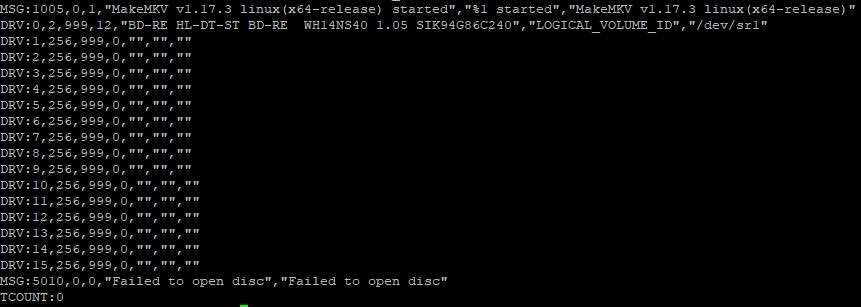

Command run and it appears that it does detect the drive though it has a "Failed to open disc","Failed to open disc" message.

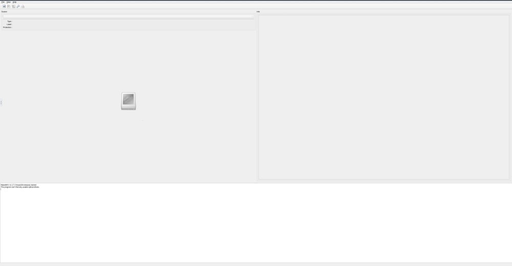

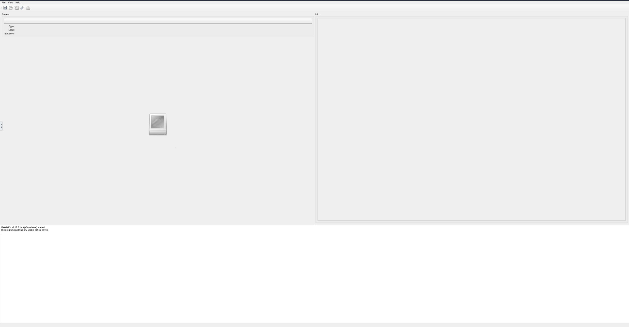

I've attached a screenshot of the output of the command. I've also included a screenshot of what the docker gui looks like.
Edited by supawiz6991
Additional screen shot

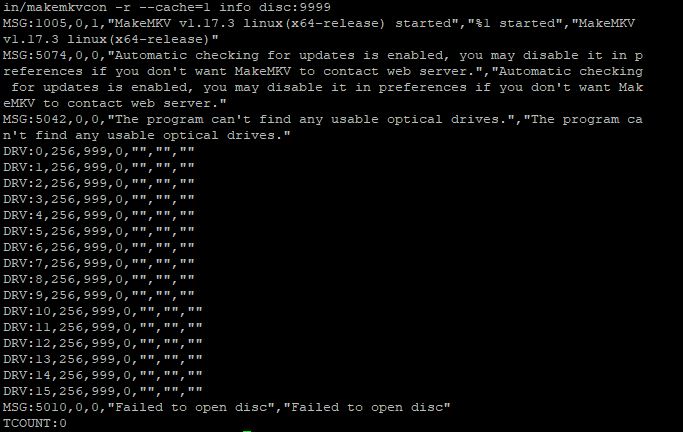

Do you get the same result with:
docker exec MakeMKV su-exec app /opt/makemkv/bin/makemkvcon -r --cache=1 info disc:9999
Negative. This command returns ""The program can't find any usable optical drives.","The program can't find any usable optical drives."

[cont-init   ] 54-check-optical-drive.sh: executing...
[cont-init   ] 54-check-optical-drive.sh: looking for usable optical drives...
[cont-init   ] 54-check-optical-drive.sh: found optical drive [/dev/sr0, /dev/sg3], but it is not usable because:
[cont-init   ] 54-check-optical-drive.sh:   --> the host device /dev/sg3 is not exposed to the container.
[cont-init   ] 54-check-optical-drive.sh: found optical drive [/dev/sr1, /dev/sg4], group 19.
[cont-init   ] 54-check-optical-drive.sh: WARNING: for best performance, the host device /dev/sr1 needs to be exposed to the container.
[cont-init   ] 54-check-optical-drive.sh: terminated successfully.
[cont-init   ] 55-makemkv.sh: executing...
[cont-init   ] 55-makemkv.sh: checking for new beta key...
[cont-init   ] 55-makemkv.sh: registration key already up-to-date.
[cont-init   ] 55-makemkv.sh: getting supported drives...

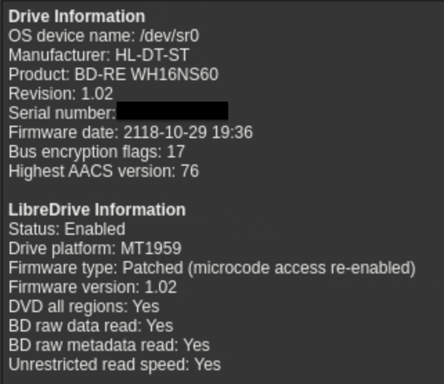

are you guys flashing these drives with MakeMKV firmware? if not it sounds like the cert is being revoked
 Host key/certificates are regularly revoked through the propagation of new Blu-ray discs. Once revoked, a drive is not able to read both new and older discs. This is usually irreversible and can only be fixed by providing a more recent Host key/certificate (for Windows users, this corresponds to updating their software player).
flash the drive with the MakeMKV Firmware and this will never happen again!
I bought an Asus preflashed off makemkv forum. The LG I flashed myself and they are still working, but like I said it'll stop reading after awhile. I put my ASUS drive back into my server, and it is working again after having it on Windows. All I did was put it in an external case, and swap it out with my LG drive that stopped working on my server. Really peculiar.
