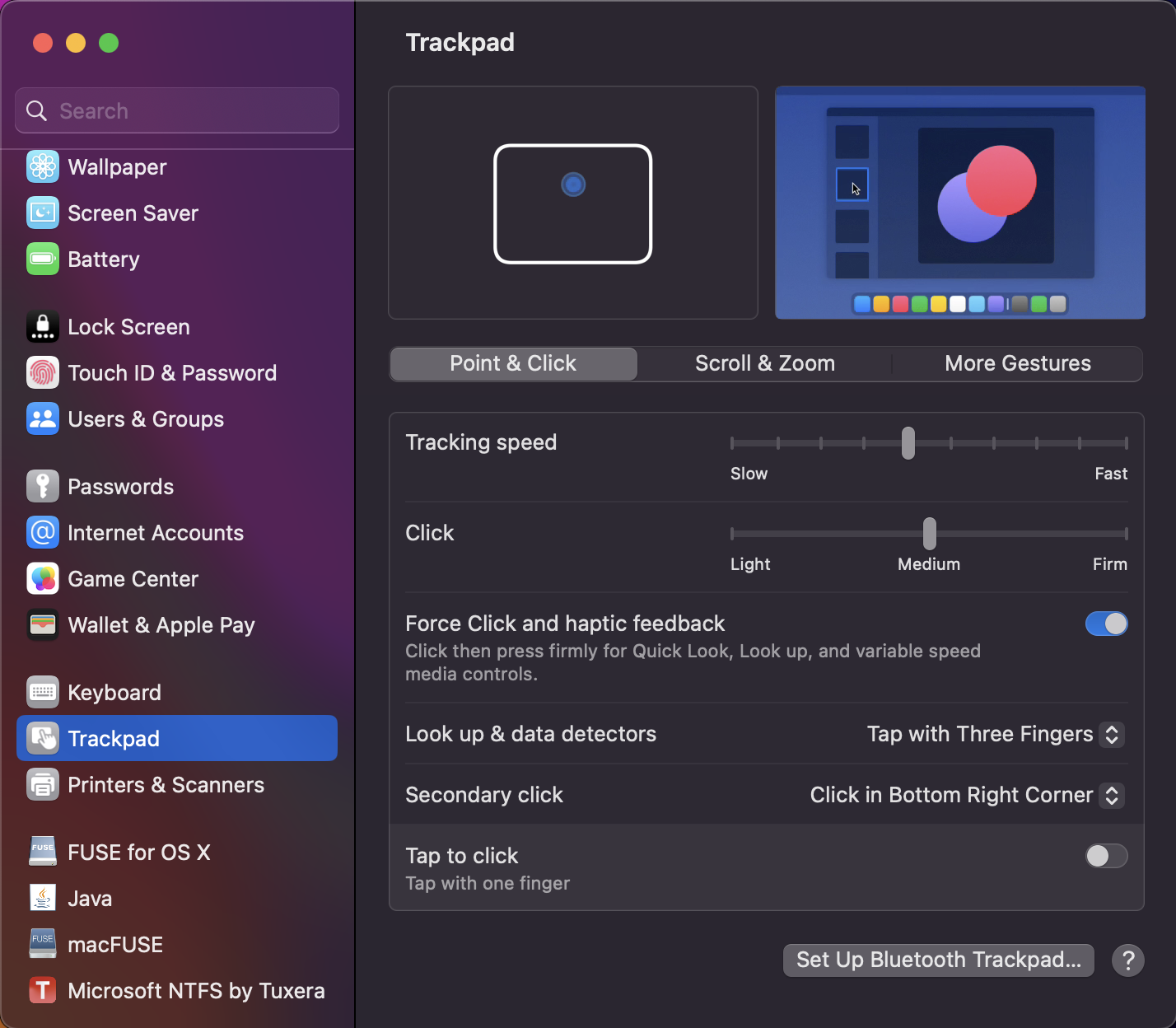

On 2/20/2023 at 8:30 PM, dakotahardy3 said:
Whelp, I am trying to switch my main computer to a MacBook and you have to press the control key to initiate a right click
just change it to click bottom right corner for secondary click:
  • 4 weeks later...
Doesn't work. Right click just doesn't work in the docker image.
It's all good though.
Yes it works well on my MacBook.  I've set the trackpad's secondary click to "Click with Two Fingers".

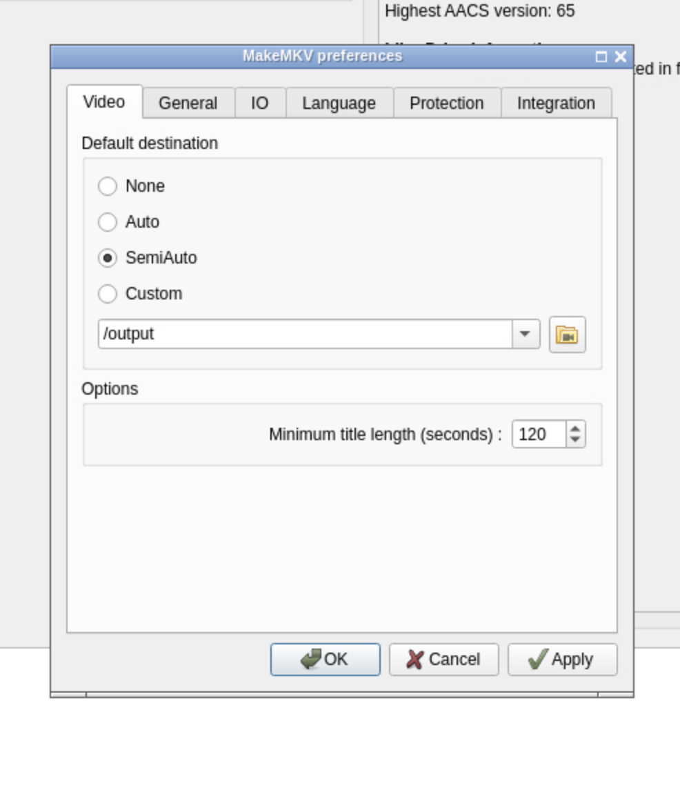

Any idea how I can change the skip length during scan from 120 seconds?
Do you want to rip a disc using the UI or the Automatic Disc Ripper ?
Thank you for your reply.
What I would like is this:
  • I want to use the UI so I can select the titles before ripping (I don't want sub-titles, alternate audio, or CC, for example)
  • therefore, when I insert a disc, I want nothing to happen
  • I click to scan the disc
  • those titles that are shorter than 30 seconds (rather than the 120 seconds now) are automatically skipped
  • I select which titles and audio tracks I want
  • I choose the destination folder if it's not already set
  • I click to rip the disc and store the selected titles into the destination folder
  • when done, the disc ejects automatically (this isn't happening now even with   -e 'AUTO_DISC_RIPPER_EJECT'='1')
I suspect that these "AUTO" settings only apply if auto-ripping is enabled???
Perhaps auto-ripping with the minimum length skip plus automatic eject is the way to go...
Edited by 4WoofGrrrr
Does the setting in the UI handles this?  Sorry.  I thought the environment variable would override
All settings/variables related to the automatic disc ripper don't apply to the MakeMKV UI.
You can adjust the minimum title length from the MakeMKV UI itself, in settings.
