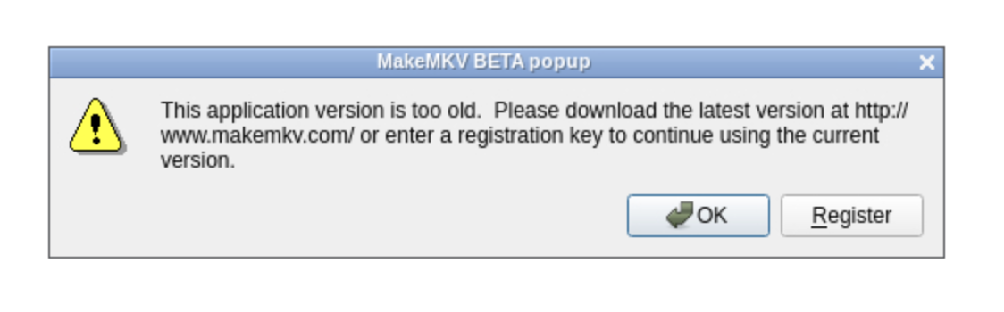

Hi - this doesn't appear to auto update to a new BETA key. I've never used this container before but I thought I would try it out and perhaps I'm doing something wrong. Let me know if I did something wrong. Screenshots attached.

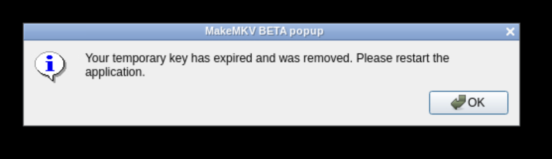

This is normal.  The current beta key is expired and a new one is not available yet.  It can take few days before a new key is made available by the author of MakeMKV.
http://upload.forums.unraid.net/live/monthly_2023_10/1401915322_Screenshot2023-10-01at8_20_17AM.thumb.png.7fa239e354f7d1197cdf752c37877a6e.png
http://upload.forums.unraid.net/live/monthly_2023_10/1582454719_Screenshot2023-10-01at8_20_25AM.thumb.png.f02b56edd6af88fa552339732ee56c67.png

1 hour ago, spl147 said:
You used the program, the key expired, so BUY the Program!
What I wrote: "I've never used this container"
What you wrote: "You used the program"
Not sure how else to word it. I've never used it, so what should I buy? Something that doesn't appear to work?
Thanks for the other replies; I'll wait for a new BETA key (because apparently it's free to use during BETA, so, no purchase necessary?)

Yes it free during beta, doesn’t mean you cannot buy it to support the developer!
If you use it for more than 1 key cycle, you should buy it, that what keeps development alive! Or you could just keep complaining when a new key is not published right away and maybe 1 day development stops.

I am new to unraid
I have installed makemkv docker container
tried to launch it and I am getting a message to say that the licence key has expired
then I get another pop up to say that the application needs updating and to reload it
It is then unable to launch
I have checked for updates and there aren't any
the container I am using is jlesage/makemkv
Unraid version is Version: 6.12.6

1 hour ago, jordonb said:
I am new to unraid
The current beta key is expired.  We need to wait for the MakeMKV author to publish a new one.
See https://github.com/jlesage/docker-makemkv#expired-beta-key
