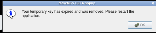

Hi, it's the new year and the MakeMKV docker has stopped working. It was working a few days ago. Please see screenshot below.
beta key has expired, time to buy a license!
I purchased a key but am still receiving the below message.  I entered the key into the "key" and "value" fields in the container settings, am I doing something wrong?  I also tried entering the key manually in the webUI and that did not work.
I figured it out - turns out I was entering my license key into the wrong field(s), I was trying to enter it into a combination of the "key," "value," and "default value" fields. I looked at the github and figured out I needed to enter "MAKEMKV_KEY" into the key field (needs to be all caps) then enter my license into the value field. After that I was up and running.
Note that the template already has a field named "Licence Key" for this.

Temporary licence key has expired. When is this docker expected to be updated?
Why not ask in the makemkv forum where the key is released? Or better yet buy one!!
the creator of this docker has no control over when a new key is posted!
a little google search would of answered your question

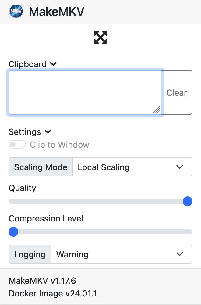

Can someone explain what these Quality/Compression Level settings are in this image? My understanding is that MakeMKV has no such settings.
they are vnc / spice visual control to view the GUI that the application is running in.
if text was hard to read in the application or very small you would edit theses setting to make it easy to see and use.

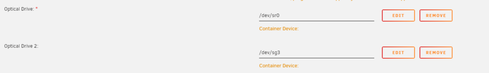

I was attempting to use MakeMKV this morning, but it stopped being able to detect Blu-Rays after the first one. I rebooted the server and reinstalled the docker container. I have just confirmed that the optical drive works with MakeMKV in a windows system. Any ideas?
The original Blu-ray can not be detected anymore. And any other cannot be as well.
Have you passed through both /dev/SRx and /dev/SGx
Yep, double checked and they haven't changed either
It usually happens when sgx changes
No change.
1 hour ago, Technologyman00 said:
No change.
Post the log showing it
UPDATE: Sorry i didnt realize the author changed the template. I updated to the new template and re created the docker and my drive is passed through properly using the new method (not sure why it is not included in the template)
you should be looking in the docker log for the drive assignment, not system devices.
below is the relevent info:
[cont-init   ] 54-check-optical-drive.sh: executing...
[cont-init   ] 54-check-optical-drive.sh: looking for usable optical drives...
[cont-init   ] 54-check-optical-drive.sh: found optical drive [/dev/sr0, /dev/sg5], group 19.
[cont-init   ] 54-check-optical-drive.sh: terminated successfully.

is anyone else getting the message that it's too old of a program even though the doker container is fully updated?
Just opened it here, works perfect!
The current beta key is expired. We need for a new one to be published.
Just buy a damn key! you guys kill me with this i can not believe there is no new key, i've been using it this way for years! if you used it and the beta key expired, it's time to buy a key! then the program to old issue will go away!
it will be a sad day for everyone when makemkv dissapears because no one supports the developers!
