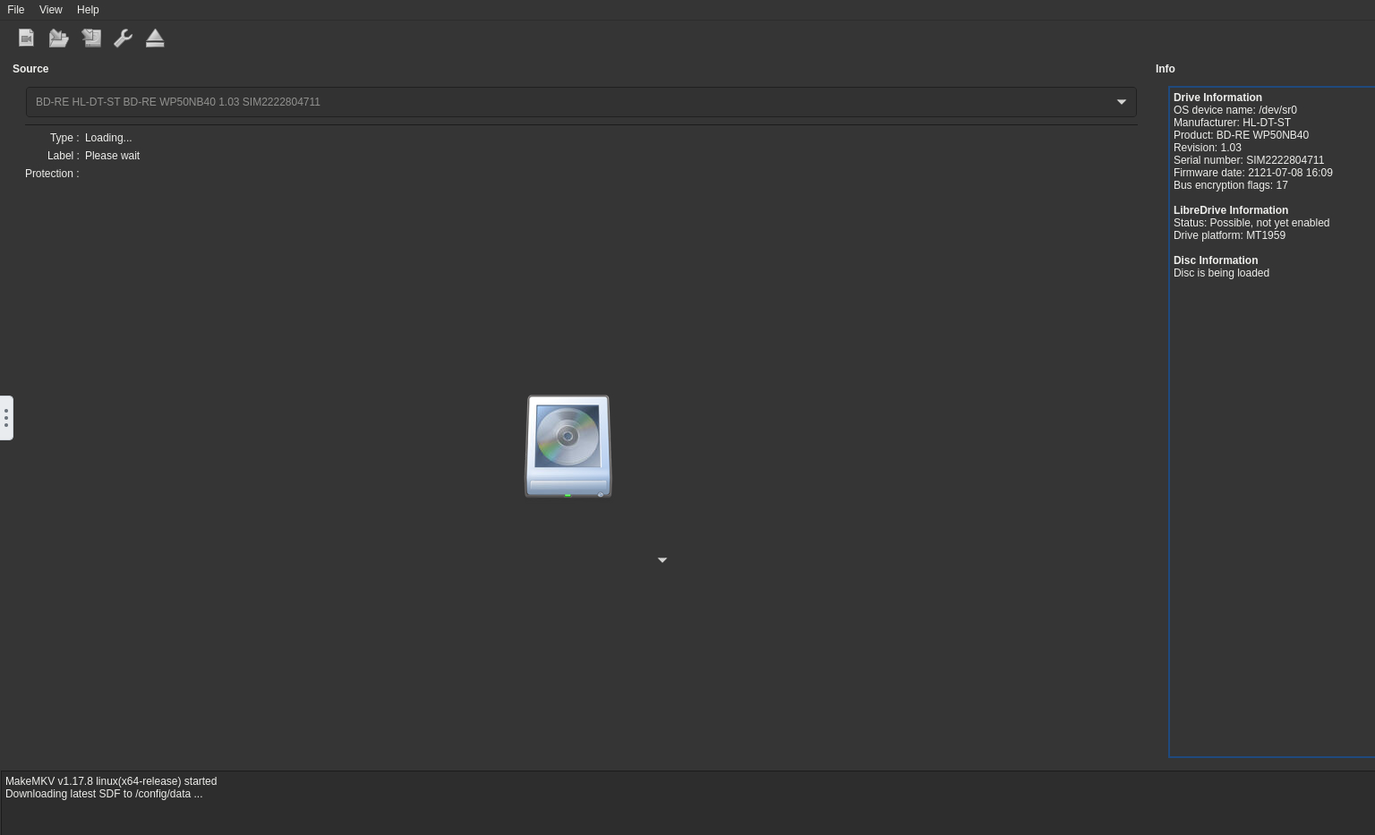

i tried searching through the posts but havent seen a solution to my issue. bought a usb dvd drive and tried to set this up. got it to see the drive but when i put in a dvd, it wont go past loading. plugged it into my pc with the same dvd and works fine. any ideas? and yes ive reinstalled it multiple times and always does the same thing
screenshots would be helpful
not all dvd driver can read movies. is the move a dvd super layer. This requires a different reader. Dvd Can't read Blu-ray that a different lens and reading apertures...
so lets start from the beginning. What disk type is your disk/movie that won't read?

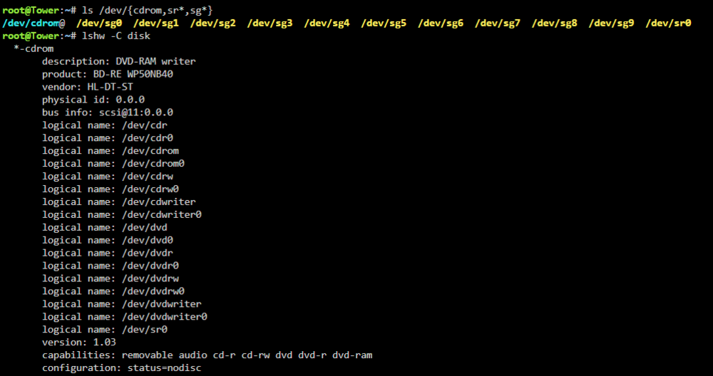

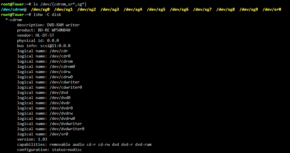

So on to the commadns to test and check...

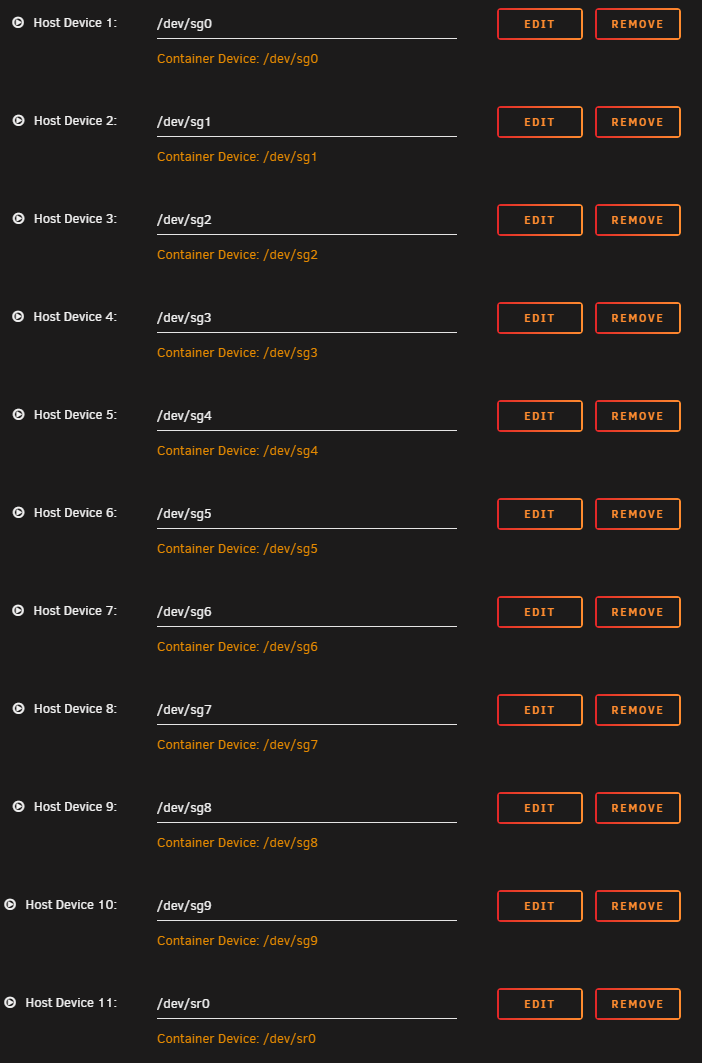

To sue Makemkv the docker your host must first see and use the disk drive. is it mounted and present?
*--It can't be mounted and in use else where!
Unraid web Ui Terminal what is the output of command:
ls /dev/{cdrom,sr*,sg*}
#and:
lshw -C disk
Example:
root@Docker:~# ls /dev/{cdrom,sr*,sg*}
/dev/cdrom@  /dev/sg0  /dev/sg1  /dev/sg2  /dev/sg3  /dev/sg4  /dev/sg5  /dev/sr0
root@Docker:~#

I'm using this disk drive connected to sata over a atapi USB device that will pass all its functions. Note the capabilities... And other logical names.
??? Do you see that at the host level? no you have a problem with how the optical disk drive is connected and being used by the host.
If yes Lets move on...

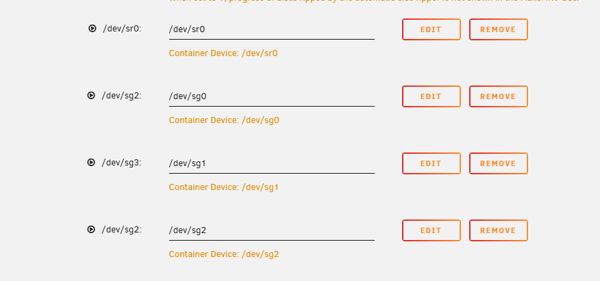

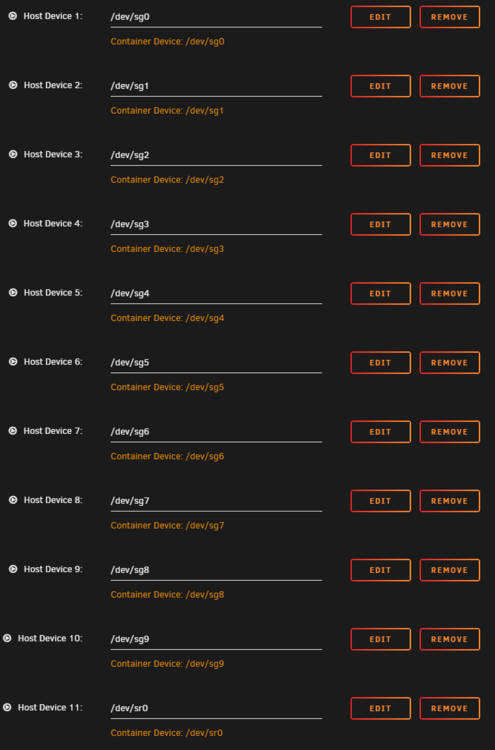

As Unriad default template for mkaemkv doesn't add the variables to use and pass the disk drive, you must edit and add this data to the template. (IT varies per macheine and enviroment due to disk drive evolution due to access to the block device...)
noted here:
not in my case I have:
I Must make a device path for each one for the makemkv docker to see and use the disk drive:
as explained here:
If its is usb passed to a vm makemkv won't see or use it... if its passed to a different docker makdmkv wont' see or use it.. if you mount it with linux commands umount the path as makemkv won't see or use it...
need more info to assist otherwise...
#and:
lshw -C disk
Example:
root@Docker:~#
as explained here:

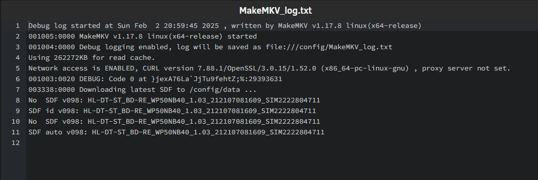

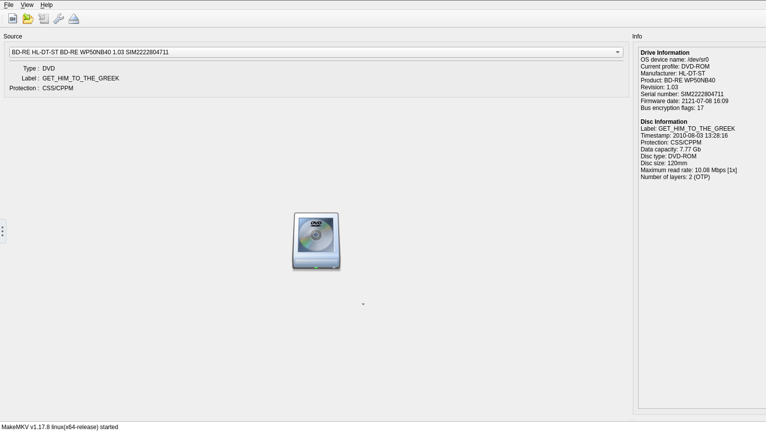

so first, the drive is perfectly functional on my windows pc and have been ripping dvd's all night. but never could get the docker to work. ive tried adding the the srx and sgy and making privileged but nothing works. it works fine until i put a disk in. then it gets stuck in the loading disk step. and i left it there for a hour just to see. i would think it was the drive except it works perfect on the windows pc with makemkv. so either i missed something in the setup or this drive is not compatible with unraid? and this is the link to the exact drive.
https://www.amazon.com/dp/B011327QXC?ref=ppx_yo2ov_dt_b_fed_asin_title&th=1
and this is where is always gets stuck
and here is the debug log

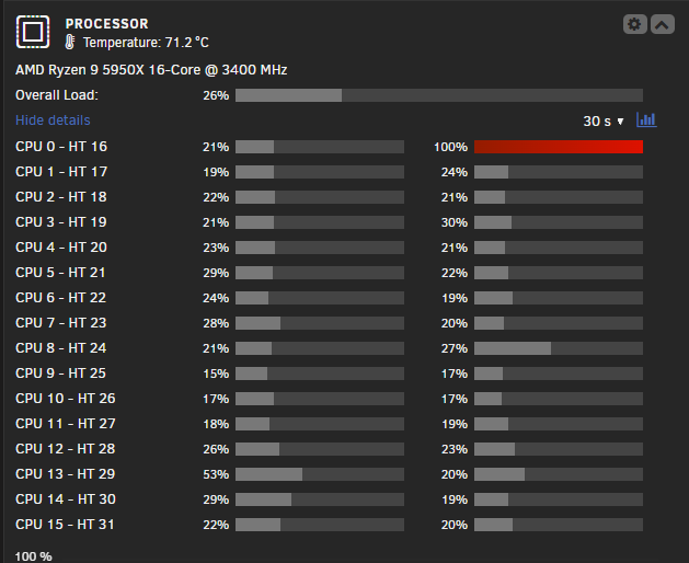

o and not sure if this is normal but it appears to only be using 1 thread which it fully maxes out.
Edited by orkid1989
ok so not sure what it does or is for but in the settings.conf i input the drive id in the sdf_stop line. now it works. no clue what it does though and if i need sdf
so i am able to rip dvvd's with the sdf disabled. hope thats ok. next question. how do you enable it to do it automatically? ive turned on the settings for the container and setup the output folder but doesnt appear to do anything automatically. am i missing something or do i need another app or something?

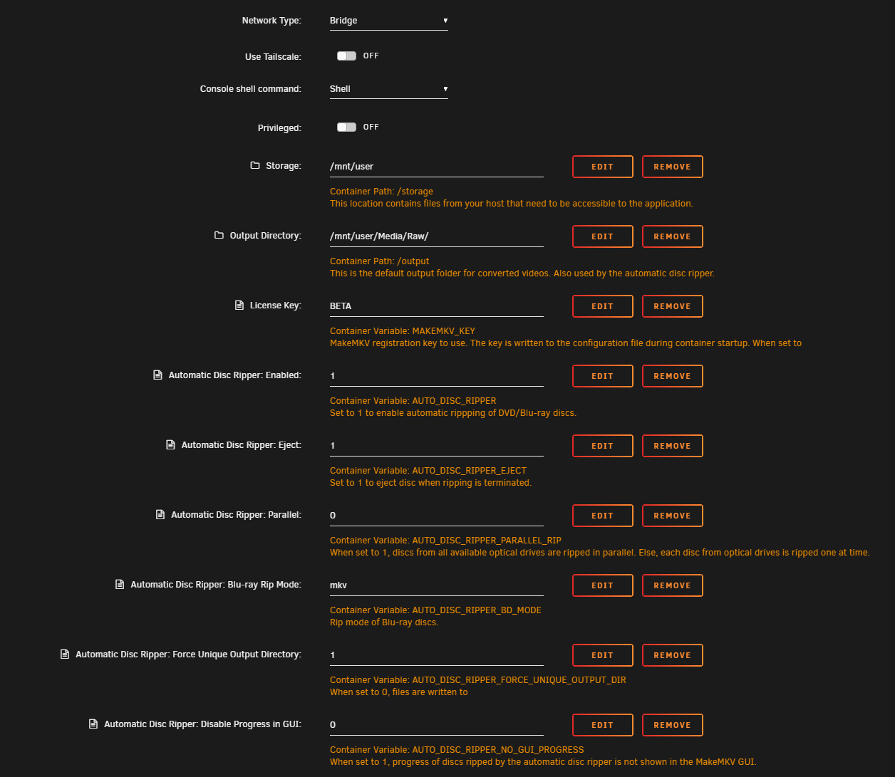

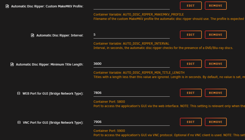

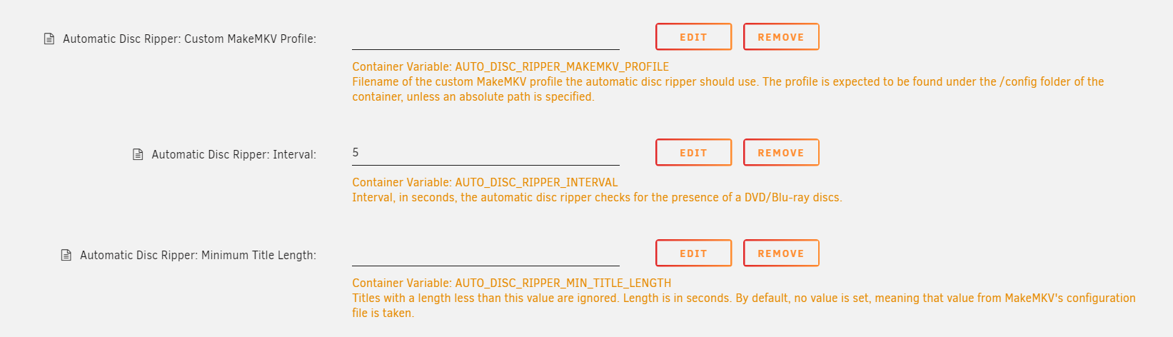

to anser your queston on unraid in docker settings you can edit the docker and click advace togle at top right and shoe more setting at the bottom. read thorugh the option and enable the setting you want. as I have make mkv able to auot do disk and eject when finished..
5 minutes ago, bmartino1 said:
glad you found something that worked for you. sdf is not required. AS i said makmkv want libreadrive your disk drive need to suport it. on widnwos how it access libreadrive is different then how linux access libreadrive.
Libreaddrive in this ascts more of a funciton on how the block reads the disk drve to get teh contect to maek a video file...

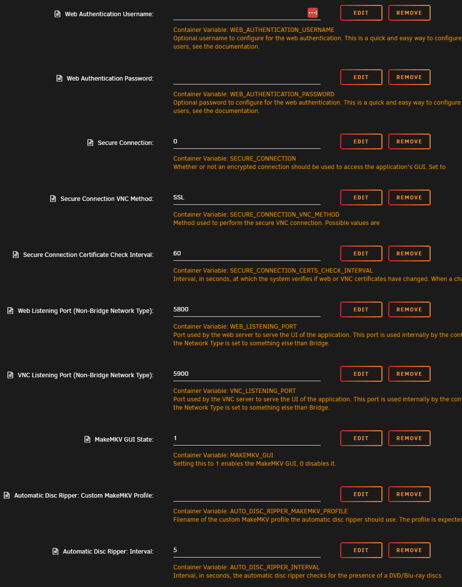

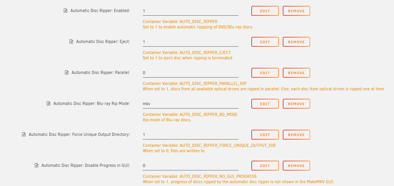

im still new to all of this. only had plex for about a week now. ive tried but have no idea what libredrive or sdf is honestly. and i have pretty much the same settings as you but doesnt appear to do anything automatically. do i need another app or service? below are the pictures of my settings.

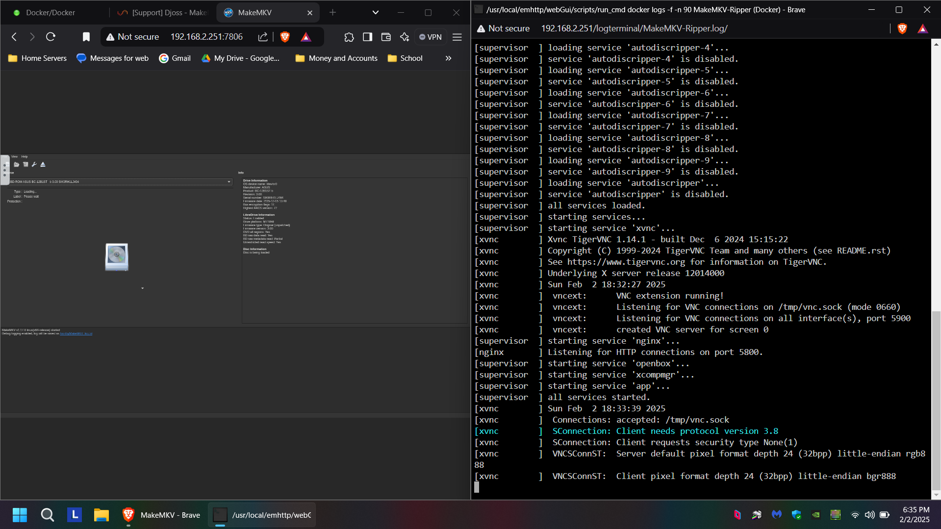

just sits here until i manually open the disk
did you insert a working disk and wait 5 ish min. if in the web ui you should evetualy see a progresss bar.

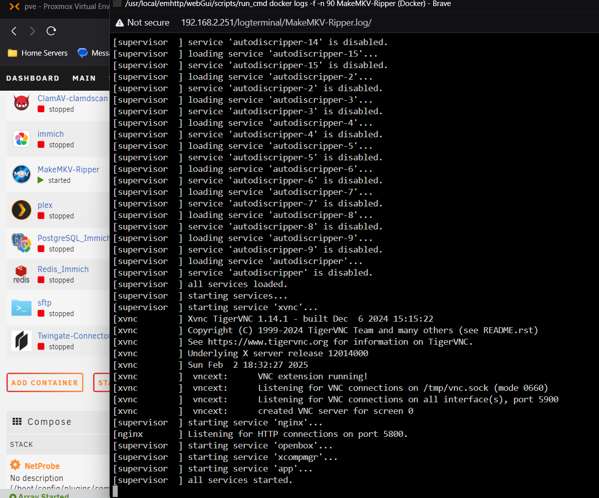

in unraid web ui if you go to docekr log you will see the output for the auto rip.

example in docker log on auto ripper...
HuH, this apears to be broken atm...
https://github.com/jlesage/docker-makemkv/issues/183
auto disk riper not running per the log... you would see auot rip settings in the log and a progress bar in the gui... weird... May be fixed latter.
according to the description it should be 5 seconds. but i have waited about 30 minutes. watching mythbusters while i wait lol. and i used the console in the docker to ping google and it worked so i assume its getting access to the internet. and my log looks the same. so its currently just broken? i usually error on the side of i messed something up lol
I've been fighitn dns issue latley in unriad v7 due to tailscale plugin. teh sdf is a internet file accesss issue. I notive that the config say 1.7 but the app say 1.8 it may have broken in a recent update.. Once i get my system stable agin ill ber back with x and y...
as I may have to go back a version:
https://hub.docker.com/r/jlesage/makemkv/tags
its a know issue atm and a fix is being processed:
https://github.com/jlesage/docker-makemkv/issues/237

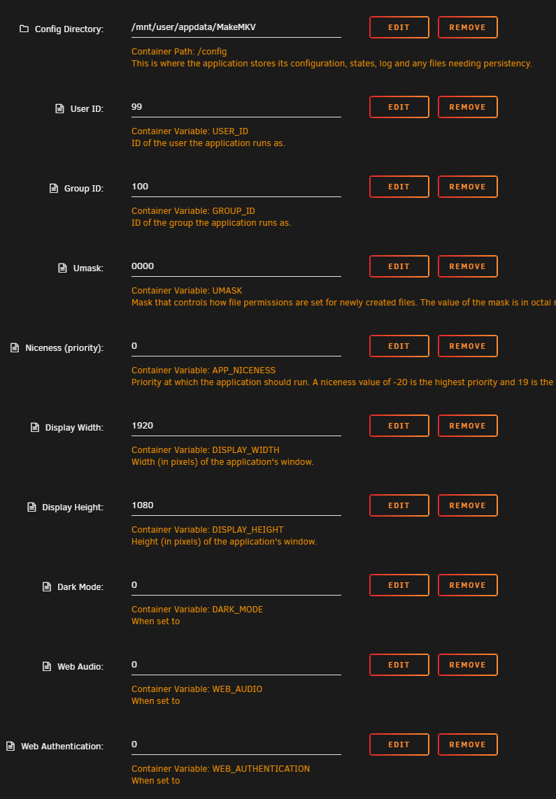

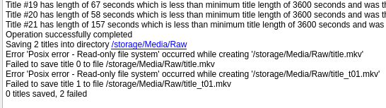

makes sense. now im getting a error i havent seen before "posix error - read-only file system". any ideas? the folder is aloud to read and write

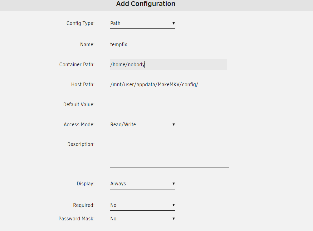

a temp fix arcording to the wrok around is to duplcate the config folder path:
is now allowing the ripper to auto rip:
postix seems like a turenas acl error..
not sure how your handling file permission. stop all docerk tool > run docker safe permission...

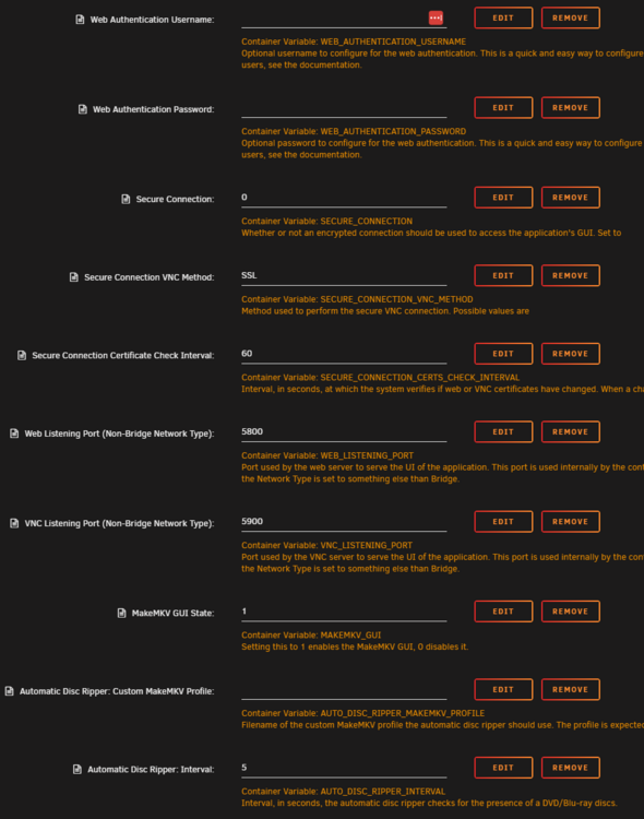

i added the new path to the docker. doesnt appear to have changed anything as far as the automatic thing. and no idea. i dont mess with premissions except to allow read and write. maybe this is drm in the dvd?
Edited by orkid1989
ok so i fixed the read only problem. apparently the "storage" path was read only. must have happened during my last clean install.
still no luck with the automatic burner thing though
Note that there is currently an issue with the automatic disc ripper for people using the beta key (MakeMKV version is expired). A Docker image update will be available soon to address this.

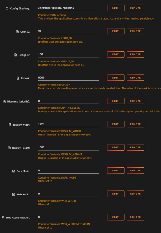

Has anyone else run into the read only problem? Have had MKV going for several years and just ran into this problem after upgrading Unraid to 7.0.0. I reviewed permissions for the Storage Path and its showing Read/Write across the board. What am I missing?
/mnt/user is not a storage path, it needs to be a share
