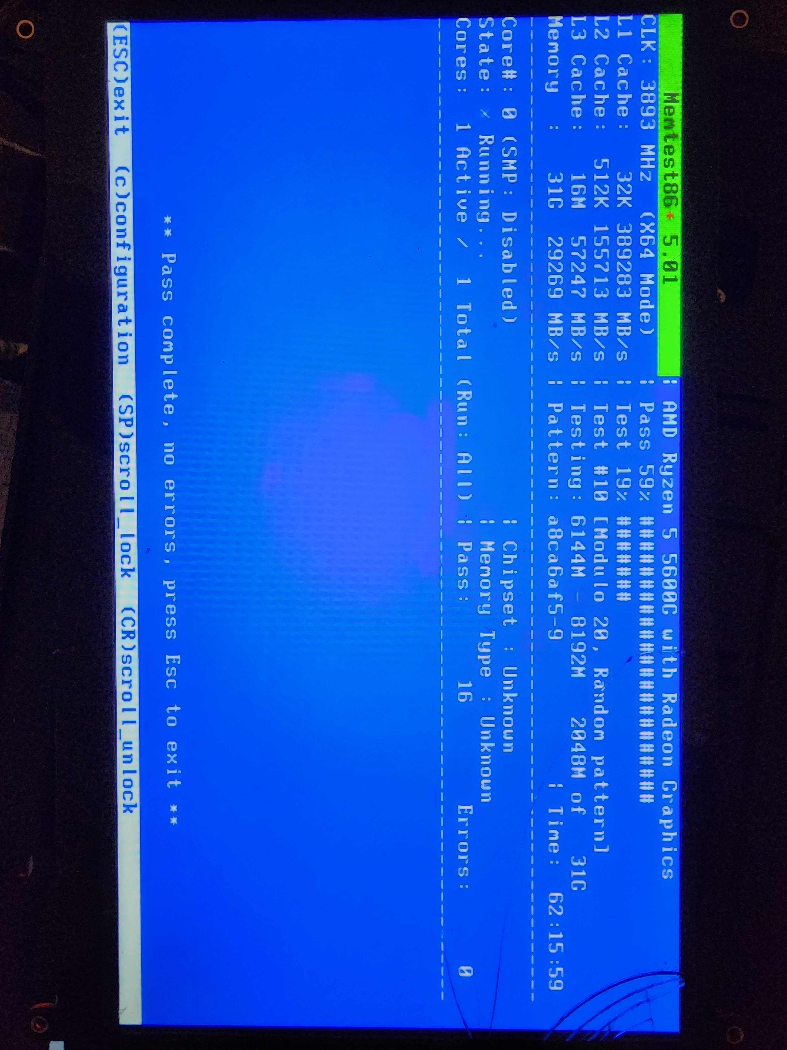

I am also wondering how long mine should last. Does it stop and say PASS? Should I just restart the system? It says it's been running for 62 hours and at the bottom it says pass complete yet the program still is running. It's on test 10 as well
It keeps going (doing additional passes) until you reboot the machine.
