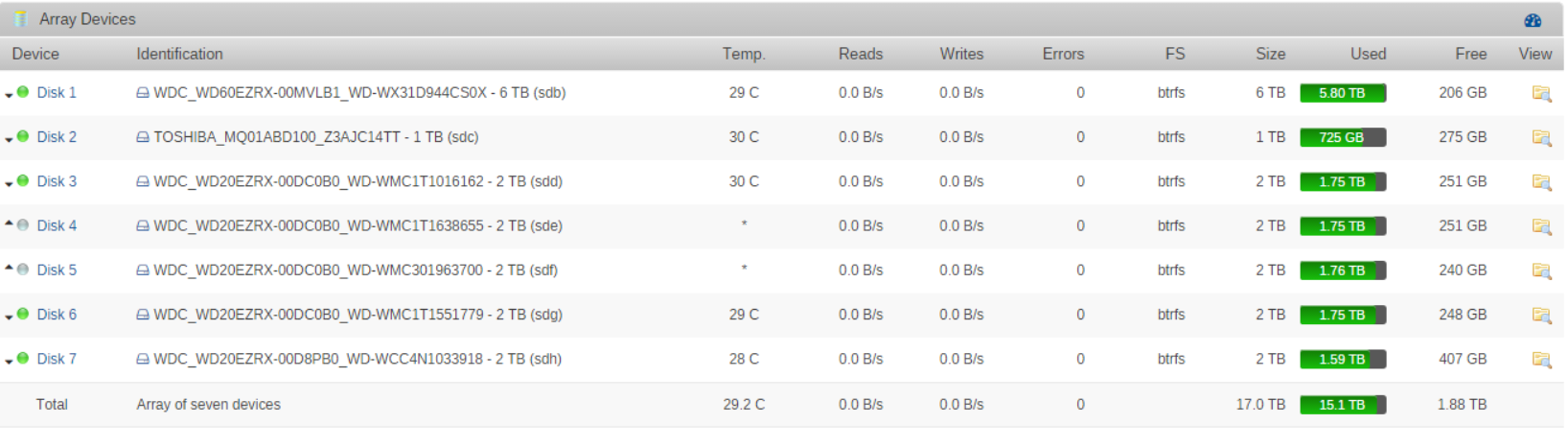

This is a good example, I have two scheduled rsync tasks (at 1AM and 1:15AM) everyday to this server, backup share is set to include only disk1 but it shouldn't matter as rsync is done directly to disk share, i.e.,
rsync -av --progress --delete -e ssh /source/ [email protected]:/mnt/disk1/Backup/TV/
The 2nd rsync task finished at ~1.20AM and disk1 correctly spun down 1 hour later, but all other disks (except disk2 which is set to never spin down) spun up during the copy to disk1.
There's nothing using the other disks except a weekly backup task on Saturdays, no dockers on this server, couple of VMs on the cache disk but no mapped server drives.
Anything else I can do to help diagnose the problem?

Command runs from another server, it's only the rsync command, sometimes only a few disks spin up, I ran it manually now a screen shows the result, only disks 1 and 2 should be spinning, disks 3, 6 and 7 woke up this time
