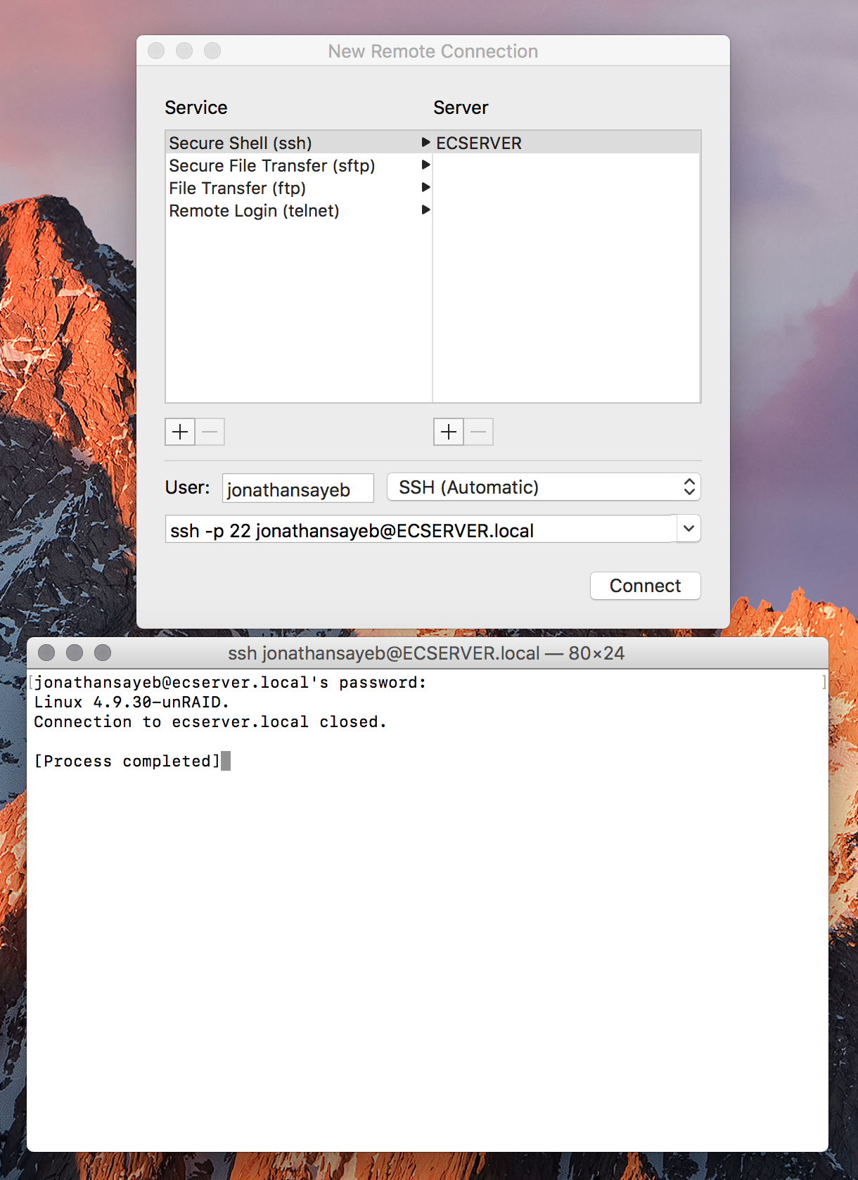

Great thank you very much for your fast reply. unfortunately i cannot get the ssh connection to work in terminal it keeps closing the connection even tho I see in the log that it has been connected successfully.
Are you talking about the unRAID system log or some other log?
Also, be very, very careful about following Maticks advice. If at all in doubt, don't do it. You could wind up deleting a lot more than you intend.
Yes that's right i'm talking about the Unraid system log which I access directly from the Unraid GUI.
Sent from my SM-G950F using Tapatalk
Finally accessed my server with ssh but and the command you gave me works to delete all non hidden files. but i'm still stuck with the .appleDB folder which won't delete

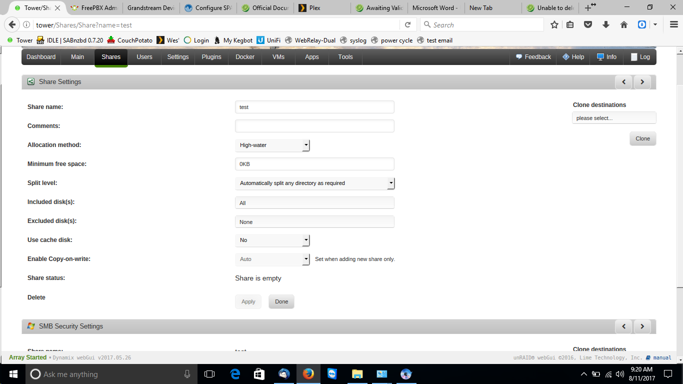

I also can't delete shares.  I don't have a check box like they talk about in the 6 manual.  I'm running 6.3.5.  I also tried to delete the name of the share and click apply next to the delete button but it says I have to have a share name.  Please help.
Thanks
You can't delete a share that isn't empty. Have you tried to delete all the files and folders in the share?
Yes, just to make sure I created a new share just to make sure.  My "test" share and the one I had will not delete from the gui
This may be the firefox checkbox bug. Try another browser.
LOL!!!  No sh*t!!   It worked!!!  Thanks
