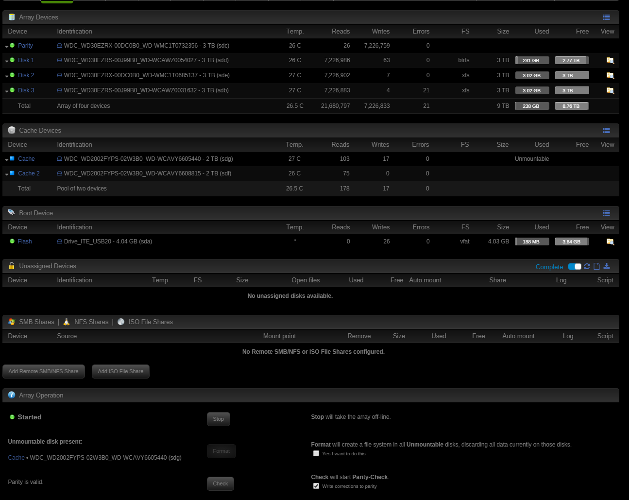

June 28, 20179 yr So I installed a new unraid. Assigned all disks for the array and cache. Everything was working.. until I rebooted the server. Array was fine but cache disk showed with a blue icon (new disk). I've tried (i think) everything (after manually copying the data back to the array): - format disks - wipefs - preclear - new config It all stays the same, disks with blue icons and no way to make it a cache pool. When I click format it says "formatting" once but when reloading the main page it's possible to click format again. Any help would be appreciated I tried a lot of searches but came up empty. thank you Edited July 8, 20179 yr by WEHA

June 29, 20179 yr Author I'm not sure what you mean, the array is fine. It's the cache pool that is not working. I did use "was" fine but it should read "is" fine I've attached a screenshot to illustrate the problem

June 29, 20179 yr Author Ok I've been trying some things: Cache slots was set on 2 because I wanted to add 2 drives. When I set cache slots to 1, it works?! Disk is then tagged as normal (green icon) From the moment I set the slots to 2 the first disk is tagged as new (blue icon) and unmountable This with either disk. EDIT: in disk.cfg cacheUUID is still empty, whereas on another test server I have an SSD mounted for cache and that actually shows an UUID Edited June 29, 20179 yr by WEHA Extra info

July 2, 20179 yr Author Seems that was the problem, reformatted sdd to xfs (instead of btrfs). Stopped and started the array again and voila, working cache disk. So this is a bug?
July 2, 20179 yr Community Expert 9 hours ago, WEHA said: So this is a bug? Not really, this a consequence of how parity works, the number of btrfs disks and if that number is even or odd, btrfs doesn't like when there's an error on one of the filesystems, and that is likely to cause issues with other btrfs filesystems.
