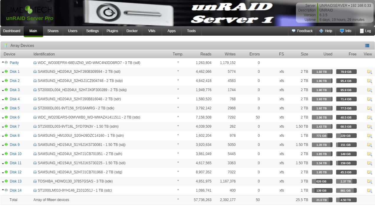

I just got notification that one of my disks has read errors but I am unsure where to go from here? is it a one-off? should I replace it?
If anyone could give me any pointers I would appreciate it! :-)
Pending sectors, replace it:
197 Current_Pending_Sector  0x0032   200   200   000    Old_age   Always       -       4

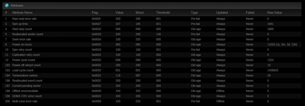

One of my similar drives for comparison :)
Device Model:     WDC WD20EARS-00MVWB0
  1 Raw_Read_Error_Rate     0x002f   200   200   051    Pre-fail  Always       -       535
  3 Spin_Up_Time            0x0027   173   166   021    Pre-fail  Always       -       6341
  4 Start_Stop_Count        0x0032   090   090   000    Old_age   Always       -       10495
  5 Reallocated_Sector_Ct   0x0033   200   200   140    Pre-fail  Always       -       0
  7 Seek_Error_Rate         0x002e   200   200   000    Old_age   Always       -       0
  9 Power_On_Hours          0x0032   024   024   000    Old_age   Always       -       56053
 10 Spin_Retry_Count        0x0032   100   100   000    Old_age   Always       -       0
 11 Calibration_Retry_Count 0x0032   100   100   000    Old_age   Always       -       0
 12 Power_Cycle_Count       0x0032   100   100   000    Old_age   Always       -       164
192 Power-Off_Retract_Count 0x0032   200   200   000    Old_age   Always       -       110
193 Load_Cycle_Count        0x0032   090   090   000    Old_age   Always       -       331914
194 Temperature_Celsius     0x0022   126   112   000    Old_age   Always       -       24
196 Reallocated_Event_Count 0x0032   200   200   000    Old_age   Always       -       0
197 Current_Pending_Sector  0x0032   200   200   000    Old_age   Always       -       0
198 Offline_Uncorrectable   0x0030   200   200   000    Old_age   Offline      -       0
199 UDMA_CRC_Error_Count    0x0032   200   200   000    Old_age   Always       -       2
200 Multi_Zone_Error_Rate   0x0008   200   194   000    Old_age   Offline      -       0

While looking at the diagnostics file, I took a look at your other drives (identified by last three chars of the serial number below).
Summary -
Drive 51J needs to be replaced IMO. You are operating at the edge of failure according to manufacturer settings.
Several (most) drives have multi-zone and/or CRC errors. (I didn't mention drive with fewer than 100 CRC errors). The CRC errors are indicative of cabling problems. I'd say you have a systemic problem with your cabling. The multizone errors I question how much to worry about them. My experience is that when they are present in conjunction with other issues, it raises my concern. These in isolation - I can't speak to. Since almost all of your drives have them, maybe best course is to just monitor. And run your non-correcting parity checks on a regular basis. I would NEVER run a correcting check on this array unless a non-correcting check indicated a small number of explainable errors (e.g., after a hard shutdown).
Suggestions:
1. Replace 511 and then immediately 51J (in that order).
2. You won't want to hear this, but your array is full of a lot of older drives that are having issues. This might be a good time to do a drive replacement cycle. A few 8T drives would replace these older 2T and 1.5T drives 4+ for 1. Use these older ones for backups.
Details:
51J:
ID# ATTRIBUTE_NAME          FLAG     VALUE WORST THRESH TYPE      UPDATED  WHEN_FAILED RAW_VALUE
183 Runtime_Bad_Block       0x0032   001   001   000    Old_age   Always       -       811
187 Reported_Uncorrect      0x0032   001   001   000    Old_age   Always       -       1935
195 Hardware_ECC_Recovered  0x001a   037   023   000    Old_age   Always       -       1940782640
Notice the Value, Worst, Thresh columns. These are normalized values. "Value" is nominally 100. "Worst" is worst "Value" that has been detected. "Thresh" is the point as which manufacturer says drive has failed. Notice that the "Value/Worst" for 2 of them are 1, and the thresholds are 0. This is extremely close to failure according to the manufacturer. And they tend to be conservative. These are not trivial attributes! This drive needs to be replaced IMO. The third one I list (ECC recovered) is also bad, but not quite as bad, but certainly nothing I'd want in my array even if the other attributes were normal.
015:
Multi-zone - 420
UDMA - 248
951:
Multi-zone - 580
968:
Multi-zone - 1300
UDMA - 18600
594:
Multi-zone - 8500
048:
Multi-zone - 520
748:
Multi-zone - 1024
160:
Multi-zone - 419
UDMA - 240
Wow, Thanks for the detailed replies everyone! Really appreciated!
I am currently moving the data from 511 now, probably the oldest drive in the array anyway! I will just keep it for backups of backups!
Drive 51J is just a 1TB drive from my old PS3 that I recently put in, it cleared ok, so not sure how it has so many errors that were not brought to light before adding it to my array!
Again, Thanks for all your replies, it made me all warm and fuzzy inside! :-D

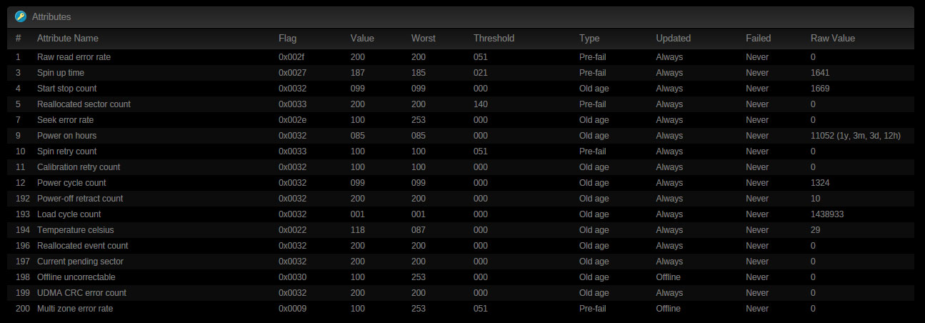

I can offer more LCCs xD
Its my WD3200BEVT working as unassigned device.
Edited by Zonediver
Zonediver is now in the lead! :-D

There is no way to reset the SMART values.
Not sure about monitoring tools. Dynamix already has some built in. I monitor mine before and after parity checks to see if any new issues are occurring. A little knowledge about the ones to watch out for is helpful, but it is not rocket science.
I heard a rumor on here a couple years ago that there are utility suites available that CAN mess with stuff like that, but that you can only get them from the manufacturer, and it's very large $$$. Typically used forensically. Or something like that.
I do know that when they refurb a drive the manufacturer resets the smart settings. So I it is possible. But if such a tool were available, someone on eBay could sell you a failing drive as new. I think such a feature would quickly become common knowledge and people would be screaming to not buy drives on eBay.
I think the up front investment and legal hoops necessary to obtain said tools would make it extremely unlikely that someone would jeopardize their business by resetting and reselling failed drives on eBay.
