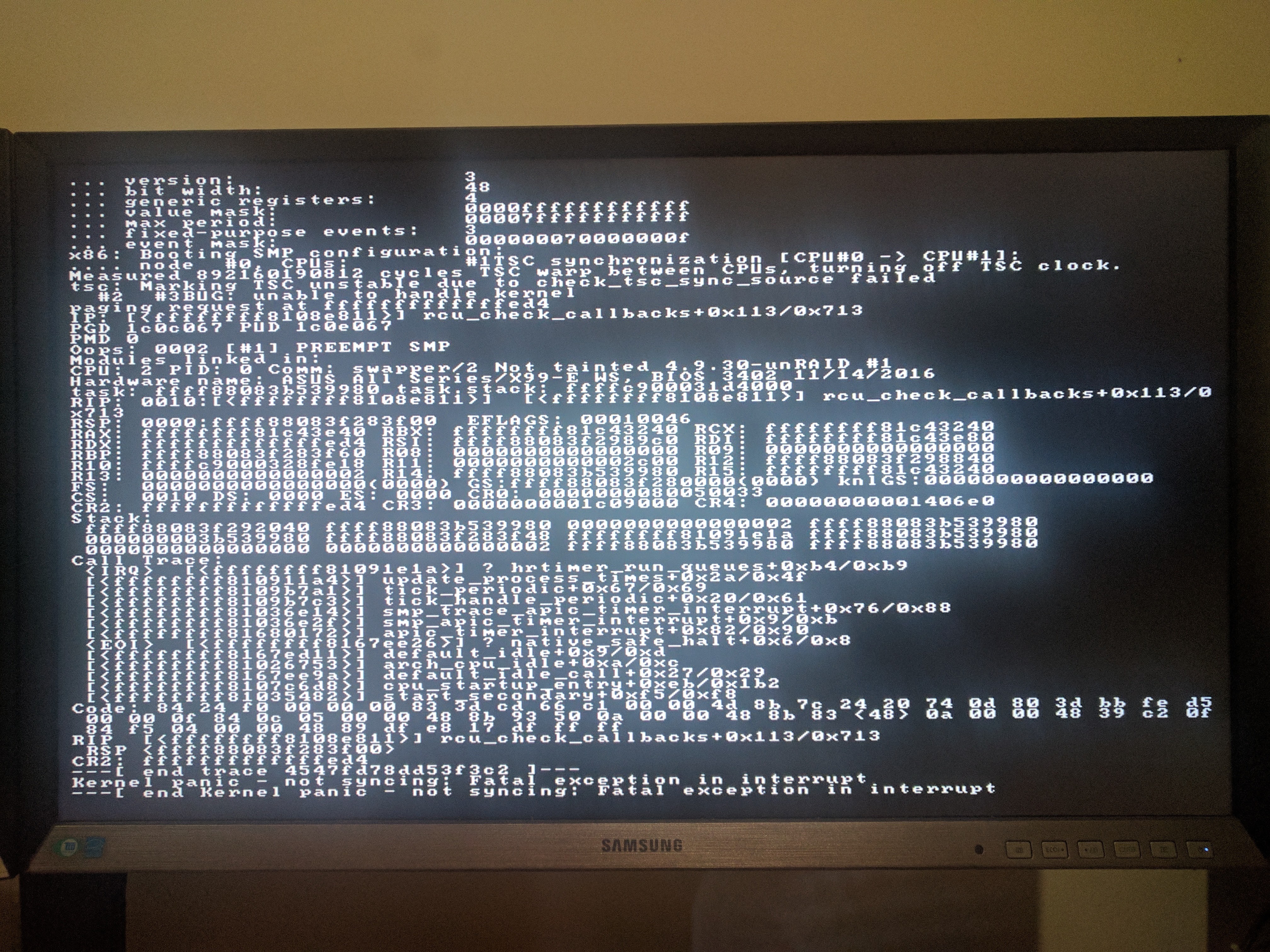

Hi Guys,
I have been running UNRAID 6.3.5 for the last few weeks without any issues. Last night the machine locked up and I needed to hard reset it. When I rebooted; very early into the boot sequence, pretty much straight after loading the boot.img file, the kernel posted  a kernel panic. I originally thought that the USB key was corrupted...and it was.....so I performed a chkdsk in Windows and repaired it however this did not fix the problem. I have since backed up the USB key and performed a fresh install with and without my /config folder however as soon as the boot img file is loaded I receive the following error.
The USB key is fine, I tried another key and a fresh install and it comes up the same error.
I have run memtest for.....2 passes for 6 hours without any errors. I am going to run it again overnight but honestly don't think I will encounter any issues. The BIOS has the very latest update....dated May 2017.
I am unable to boot in any mode, shell, GUI, safemode with no plugins etc.
As a sanity check I reverted to an older BIOS and also reflashed the current BIOS.
Everything is at its default clocks, voltages etc......
The error is consistent and always the same.....
I have also pulled two sticks of memory and also swapped memory sticks and banks.....
I am at a complete loss and have been trying to diagnose this now for the better part of a day. I am unable to access UNRAID in any way so am stuck.

Thanks for the advice everyone. I must have been having a blonde moment; I do have HDD cages in this machine with hotswap capability. I have tried pulling all the drives; I have also tried disabling all the peripherals in BIOS; I even pulled SATA cables thinking it might be a bad cable.
I have managed to get a loan of some memory and unfortunately I am still having the exact same problem.
This has been going on for almost two weeks now; I really need advice from someone on this forum who has had experience with this sort of thing.
My friends are telling me to bin uNRAID and install Windows!! I am actually considering this as I have no idea if its something peculiar(bug) to the uNRAID kernel?
I have tried a clean install of the uNRAID USB key; safe mode etc......the error is always the same. Can someone please take a long close look at the screen capture......
Can someone supply uNRAID 6.4 RC6 on a zip file please? Obviously I am unable to down this via plugin.

Here is what I get with a fresh/different USB key and unRAID 6.3.4. Its a different error message; CPU?

Ok,
I have narrowed it down to Core 2 on my 5960x. If I disable that core in the BIOS, unRAID boots and works as expected. If I enable it it kernel panics.
I have tried to install Windows 10 natively via bootable USB  key with Core 2 enabled, and it BSOD before the Windows Logo is even loaded. The problem is the same and repeatable.
I know this could still be motherboard, but I disabled Core 2 and booted the Intel Linux CPU Diagnostics Util, it boots off a Fedora USB key and ran some tests, both CPU(Core 2 disabled) and PCH (on mobo) passed.
When I tried to boot off the Intel Linux Diagnostics CPU Util USB with Core 2 enabled the system froze very early into the boot process.
So for now it does look like it's a failed Core. Will RMA CPU and report back.
