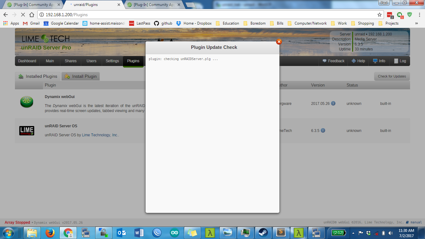

When I check for updates it stays stuck at
plugin: checking unRAIDServer.plg ...

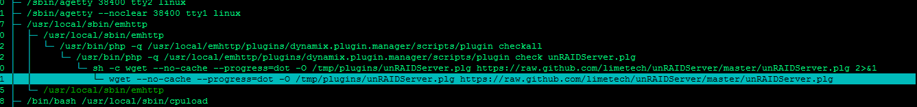

I looked at top via ssh and it gets stuck at
wget --no-cache --progress=dot -O /tmp/plugins/unRAIDServer.plg https://raw.github.com/limetech/unRAIDServer/master/unRAIDServer.plg
