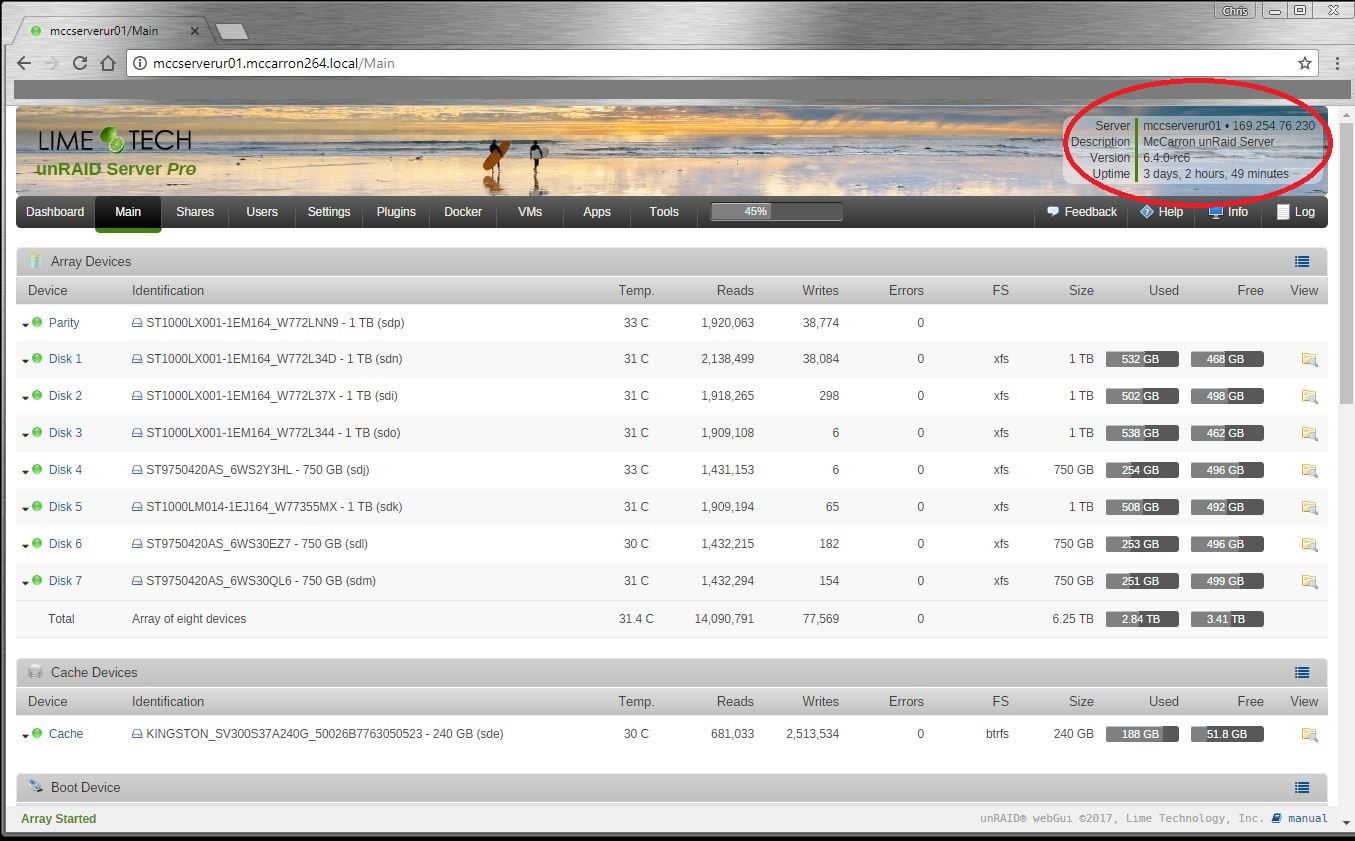

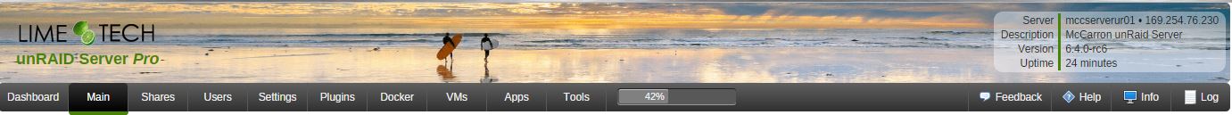

The server is assigned 10.205.1.6 notice it is reporting that it is assigned 169.254.76.230

That is correct.  The address is assigned from my Unifi controller on the network which is also the DNS server.  This 169 address thing only started when I installed 6.4 and the problem disappears if I disable the docker process.  This new docker process has some sort of DHCP functionality that needs to be disabled if not being used.  My Unifi Controller assigns the correct address to bond0 but during the boot process it must get a temporary bogus address from the docker DHCP process.  Again, my bonded connection only started failing since 6.4.  I really do not think it is a problem with then bond itself, I think the docker DHCP process is somehow screwing up everything.  All I have to do to fix it, is uncheck 1 NIC from the bond, recheck the NIC and click apply.  The bond is then properly reassembled and starts up (although the screen does not refresh properly which is another problem).  I do the same thing to the second bond and then turn my dockers and VM's back on.  Its just a pain in the ass!

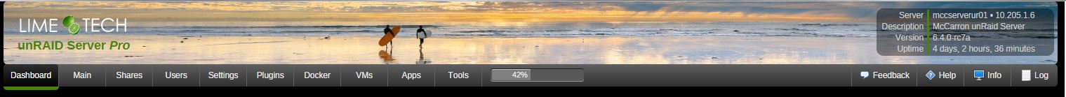

Ok @bonienl, I manually updated the network.cfg file as you described.  I can now reboot my server and the network will come up correctly but it originally still gets that bogus169.254 address.  The unRaid GUI shows the incorrect address but ifconfig shows the correct address.  When the system is booting bond0 is assigned the 169.254 address.  This did not happen in 6.3.5.
