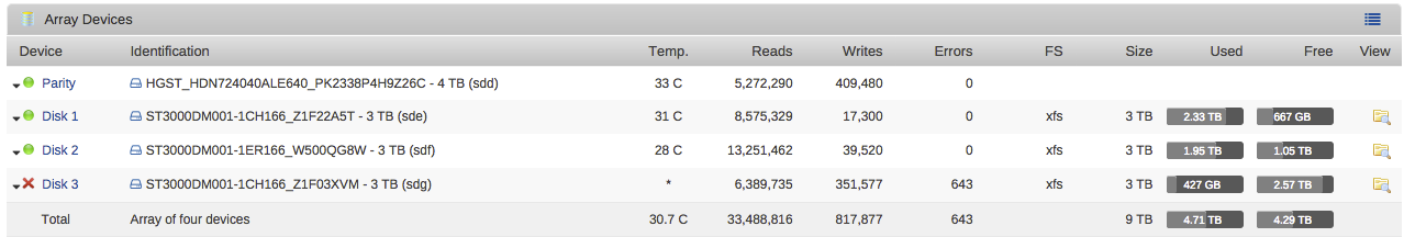

First, I had a drive fail - so if that's the source of this then simple enough i guess. Its still currently failed, until I can get the replacement.
595aabebbe7ec_ScreenShot2017-07-03at3_39_13PM.thumb.png.d054957af501c00a16ee5dc526eb51a2.png
My log file is filled with these entries:
Jul 3 15:35:01 ur01 emhttp: err: get_fs_sizes: /mnt/user/data statfs: Input/output error
for each of my shares. I tried to log in and touch a file on a user share, same problem -
root@ur01:/mnt/user/data# touch test
touch: cannot touch 'test': Input/output error
I presume I should still be able to write with a failed drive, but maybe I am mistaken? Or is something else going on?
Thanks in advanced.

You'll need to reboot and get new diags to get a SMART report for the disabled disk but looking at the logs it does look like a bad disk.
I rebooted and grabbed a new diagnostics (attached). Now I seem to be able to write to it...  Any idea what might have happened? More to the point - will it happen again?
ur01.marx.local-diagnostics-20170703-1645.zip
Disabled disk is still offline, possibly dead, but try cycling the power to make sure.
