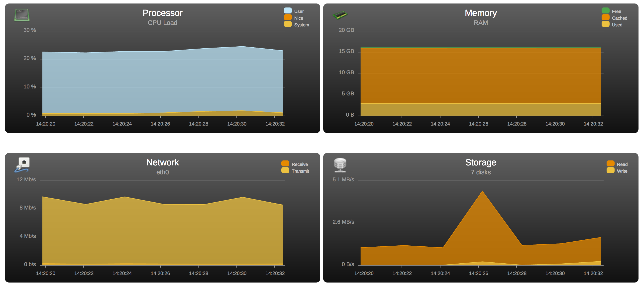

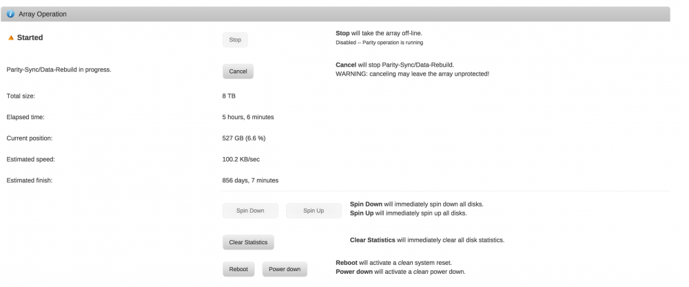

I started the parity sync and everything was rebuilding nicely at average 140 mb/s until few hours ago where it just went to 84.4 kb/s, yes that's not a typo i mean KB. The estimated finish sayd 935 days, 20 hours, 2 minutes!!!!!! (See attached screenshot)

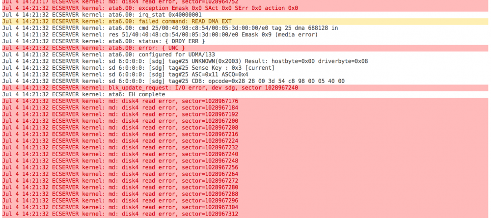

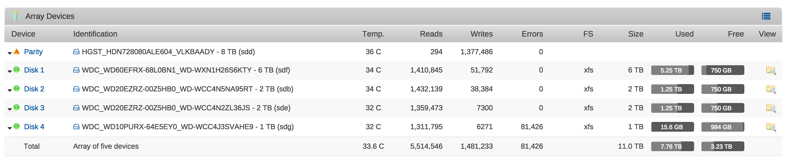

Something definitely went wrong so i checked the log and it seems that my data drive number 4 has read errors which i think might be the cause of the problem.
Please tell me there is a solution without losing my datas.

You should see if you can get a SMART report for that drive.   If not it is possible that the drive has dropped offline (which would typically be caused by a power/SATA cable issue).
Hello Is it what you are talking about?
ATA Error Count: 56 (device log contains only the most recent five errors)

would it be doable to stop the parity rebuild, leave the newly installed Hgst 8tb as parity drive, unassigned the disk 4 which seems to be faulty, power off, remove the faulty drive, replace with the previous parity drive ihad in the machine before (wd red 6tb), power on, rebuild the parity?
I would relax about possible data loss. I don't think you are at high risk at this point. Just don't do anything foolish!
What you posted is the very bottom of the smart report. Post the rest of it. Posting the diagnostics file is best. It will contain the smart reports.
So far what I am seeing is very consistent with a bad or lose cable. Do you have drive cages? Without them this is very very common.
If this is indeed a calling issue, and should cancel the rebuild, power down the server, secure the drive cables, and boot. You should be able to retry the parity update.
Looks to me more like a bad disk, but like Brian said post your diagnostics, and don't write anything to the array, were there any new writes since the parity change?

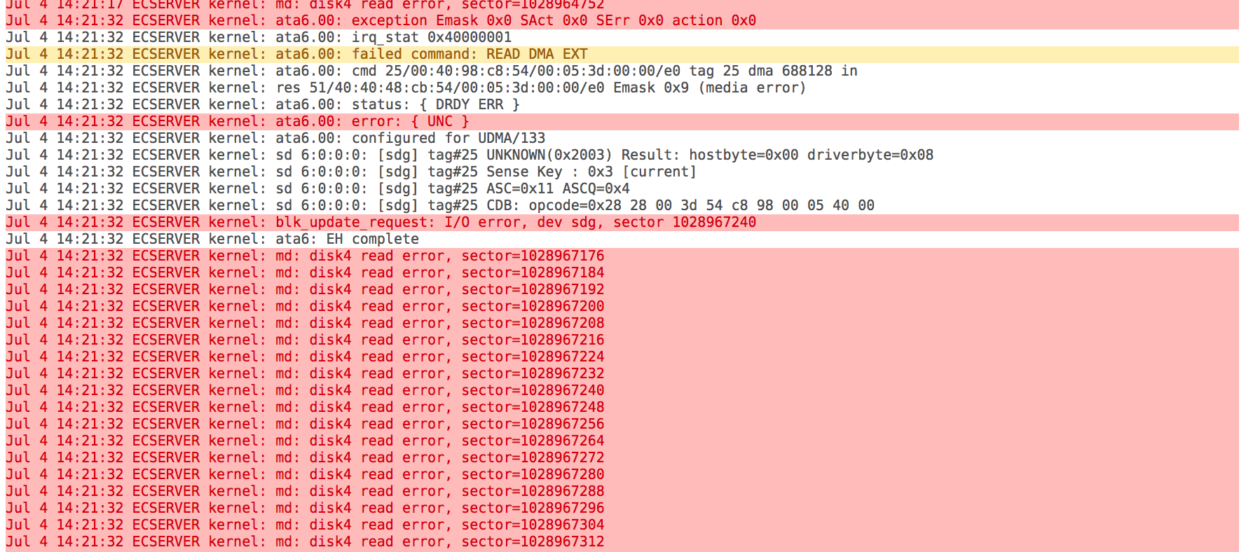

  c8 00 08 50 5f 06 e4 08   4d+11:03:13.228  READ DMA
  c8 00 08 48 5f 06 e4 08   4d+11:03:13.228  READ DMA
Error 55 occurred at disk power-on lifetime: 10488 hours (437 days + 0 hours)
  When the command that caused the error occurred, the device was active or idle.
  After command completion occurred, registers were:
  ER ST SC SN CL CH DH
  40 51 00 f0 4b 3a e9  Error: UNC at LBA = 0x093a4bf0 = 154815472
  Commands leading to the command that caused the error were:
  CR FR SC SN CL CH DH DC   Powered_Up_Time  Command/Feature_Name
  c8 00 88 98 49 3a e9 08      03:38:57.548  READ DMA
  c8 00 58 40 49 3a e9 08      03:38:57.548  READ DMA
  c8 00 58 e8 48 3a e9 08      03:38:57.548  READ DMA
  c8 00 20 c8 48 3a e9 08      03:38:57.548  READ DMA
  c8 00 20 a8 48 3a e9 08      03:38:57.548  READ DMA
Error 54 occurred at disk power-on lifetime: 10488 hours (437 days + 0 hours)
  40 51 00 90 61 2d e9  Error: UNC at LBA = 0x092d6190 = 153969040
  c8 00 c0 68 4b 2d e9 08      03:38:26.231  READ DMA
  c8 00 90 d8 4a 2d e9 08      03:38:26.230  READ DMA
  c8 00 58 80 4a 2d e9 08      03:38:26.230  READ DMA
  c8 00 70 10 4a 2d e9 08      03:38:26.230  READ DMA
  c8 00 38 d8 49 2d e9 08      03:38:26.230  READ DMA
Error 53 occurred at disk power-on lifetime: 10488 hours (437 days + 0 hours)
  40 51 00 20 a8 07 e9  Error: UNC at LBA = 0x0907a820 = 151496736
  c8 00 28 60 92 07 e9 08      03:37:05.098  READ DMA
  c8 00 20 40 92 07 e9 08      03:37:05.098  READ DMA
  c8 00 20 20 92 07 e9 08      03:37:05.098  READ DMA
  c8 00 20 00 92 07 e9 08      03:37:05.098  READ DMA
  c8 00 20 e0 91 07 e9 08      03:37:05.098  READ DMA
Error 52 occurred at disk power-on lifetime: 10488 hours (437 days + 0 hours)
  40 51 00 b0 83 03 e9  Error: UNC at LBA = 0x090383b0 = 151225264
  c8 00 10 38 78 03 e9 08      03:36:48.641  READ DMA
  c8 00 18 20 78 03 e9 08      03:36:48.641  READ DMA
  c8 00 08 18 78 03 e9 08      03:36:48.641  READ DMA
  c8 00 20 f8 77 03 e9 08      03:36:48.641  READ DMA
  c8 00 10 e8 77 03 e9 08      03:36:48.641  READ DMA
SMART Self-test log structure revision number 1
No self-tests have been logged.  [To run self-tests, use: smartctl -t]
SMART Selective self-test log data structure revision number 1
 SPAN  MIN_LBA  MAX_LBA  CURRENT_TEST_STATUS
    1        0        0  Not_testing
    2        0        0  Not_testing
    3        0        0  Not_testing
    4        0        0  Not_testing
    5        0        0  Not_testing
Selective self-test flags (0x0):
  After scanning selected spans, do NOT read-scan remainder of disk.
If Selective self-test is pending on power-up, resume after 0 minute delay.
Disk needs to be replaced, any writes or changes to the array since new parity (changes can include a docker image on the array).
And post your diagnostics: Tools -> Diagnostics
The current pending sector count has incremented to over 1900. Indeed a very bad sign for that disk.
Before doing a disk or parity upgrade, it is a good idea to do a parity check, and examine the smart attributes to make sure the drives are healthy before the upgrade. The parity check generates a similar amount of system stress as a rebuild.
Thank you Johnie. Here is the diagnostic file.
I have just realized reading the report that the failing disk has almost no data in it and that most files have been written to the other 3 data disks. Just used krusader to see what are the files in that "disk4" and they are not that important since i have backups on an external drive.
Just to make sure of the process to not do anything foolish.
1- cancel the parity rebuild
2- stop the array
3- power off
4- replace disk4 with my old partity drive WD RED 6TB (the one before the 8tb hgst i've just installed)
5- power on
(6- should i preclear the wd red 6tb that comes in place of the failing disk)
7- rebuild the parity sync.
Thank you in advance for your help
ecserver-diagnostics-20170704-1930.zip
If there's no important data on disk4 you can do that.
On step 4 you'll need to do a new config:
Tools -> New Config -> Retain All
Then select assign old parity to disk4 and start the array to begin the parity sync.
Don't see a need to preclear old parity, you'll just need to format it after array start.
Awesome Johnie, thank you so much! I'll do that now and let you know.
It seems to be rebuilding fine and I still have access to all the files! Awesome. Thank you again all!
