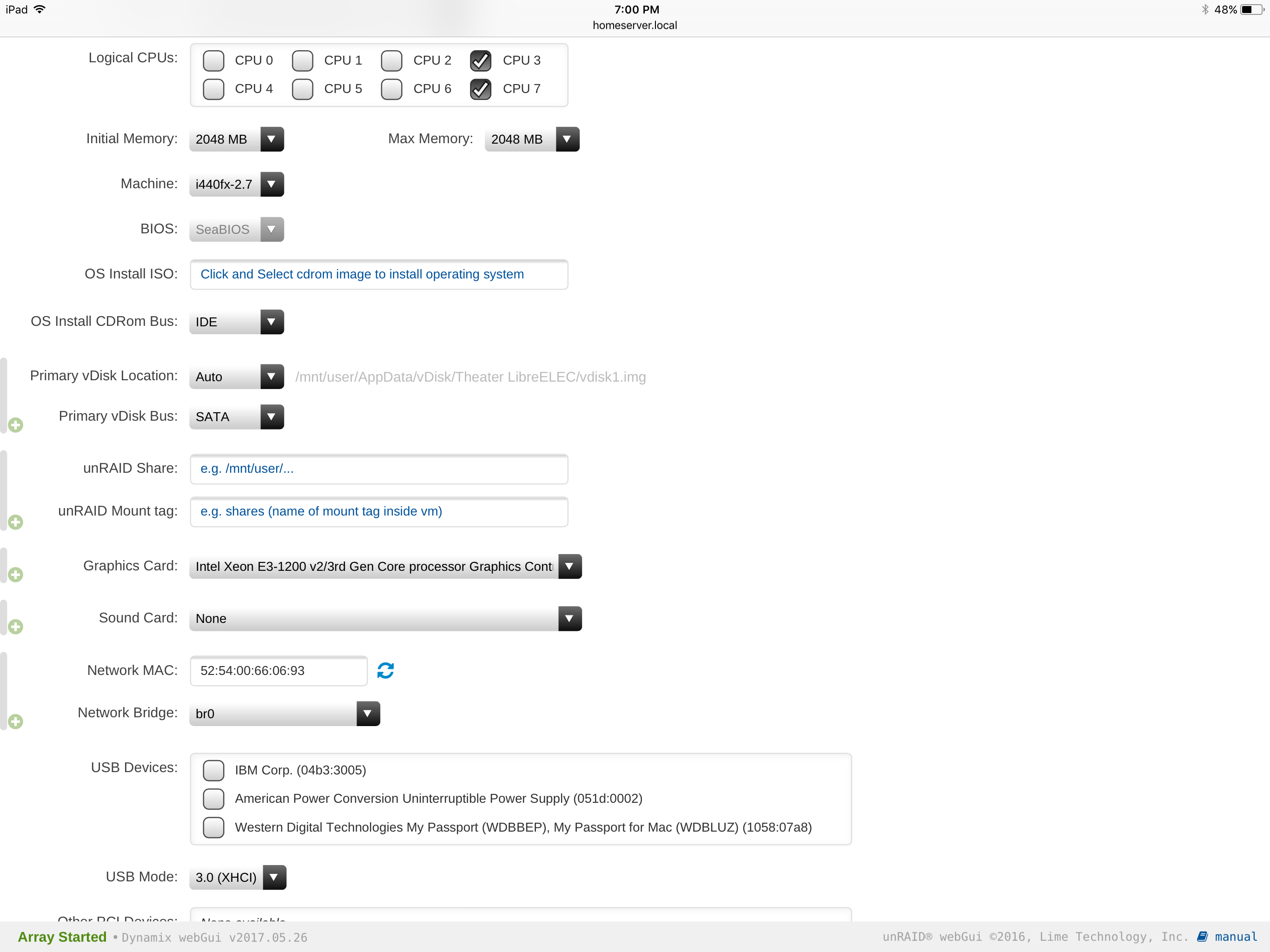

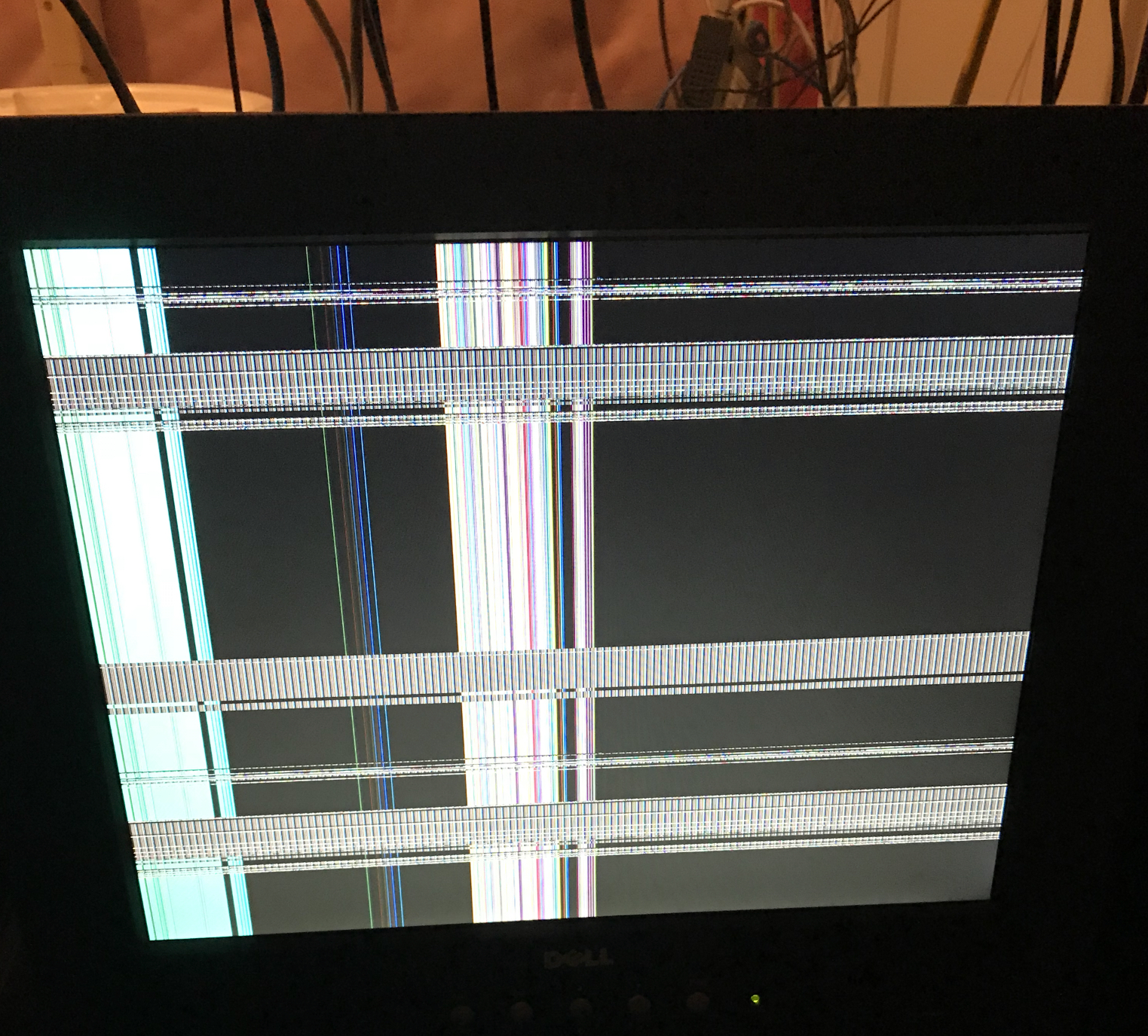

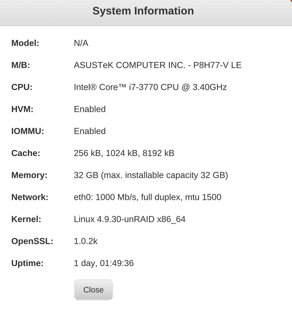

I’m trying to get LibreELEC up and running and passing the Intel GPU through to the VM, but for whatever reason when I power the VM up all I get is the garbelled image that I’ve attached.  I also attached a screenshot of the KVM configuration for the VM as well as the information on my Motherboard and CPU.  Anyone have any ideas on how I can get this working?
could be a refresh rate issue?
Which libreELEC build have you installed bisk? Is the monitor connected by HDMI?
I installed the most resent version from their site; I believe it was 8.0.2.
I hooked it up to my monitor via VGA and to my projector via HDMI and both display the same image.
I tried that build with the same result.  What I find strange is that I don't even see anything during the boot (no BIOS or POST messages like I see with my other VMs).  When the VM starts up, the screen is just the lines and never changes, so it looks like nothing is booting in the background.
I noticed the Xeon e3 CPU selection as well and just figured it was what UNRAID detected my CPU as, but it is an i7.

My CPU is the i7 3770, which is an Ivy Bridge CPU and it looks like this processor generation isn't supported (as stated in the Intel IGD Support Thread...boo!
