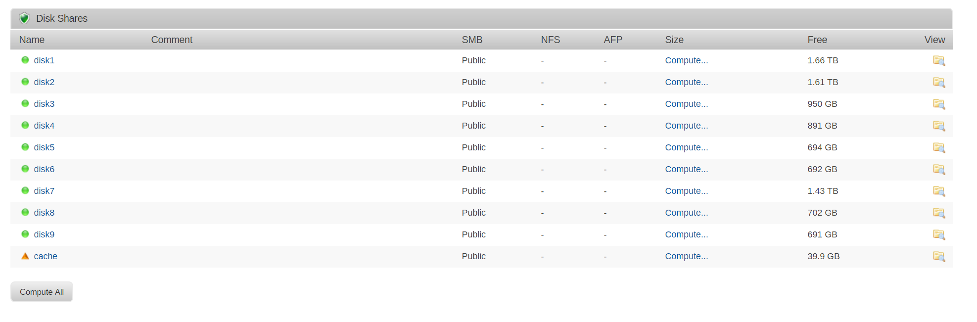

July 5, 20179 yr OK, seems this is my month for red-ball drives. I've had two this month but considering these are the only two drives have ever done this too me, its a pretty rare event. Hopefully this is it. There are a few peculiarities going on here that may or may not be relevant to the red-ball drive but I'm going to just list out points that I do know and then I'm looking for a "what now." Earlier tonight I watched a movie remotely on Plex from unRAID, no issues. Tonight I was re-installing software on a PC that was housed on my unRAID server. Looking back now, it seems at one point the response time to run anything increased, and in fact I seem to recall one specifically long hesitancy where I heard all the drives spin up. I should have looked, but i didn't. Everything kept working so on I went. Noted: I don't actually know this is when the drive red-balled, its just me looking back that it might have been. Now all that done I went to log into Plex from my PC and got a no response on the IP address. I went to the unRAID main page and see a red-ball on the only SSD in my array. Samsung_SSD_850_EVO_500GB_S21HNXAG454345K - 500 GB (sdf). This is the drive that housed the software I was installing earlier. The only connection to Plex is my music collection, cataloged by Plex is stored on the SSD. I went to the Dashboard page in Plex and found the "Apps" section didn't even exist. Nothing shown for the 3 dockers I have installed the whole section of the page was gone like I didnt have any dockers installed or running. I tried to click on the Dockers Tab. Nothing would open, nothing happened. All other tabs seemed fine. Then I noticed the parity check run 2 days ago resulted in 5 errors being found. This may be the first, but no more than the 2nd parity error found in 6 years. I can't seem to pull any smart reports from the SSD. It says it's not spun up, but we know SSD's don't spin up. I have checked cables and didn't see any obvious problems, but unRAID has now disabled it so I can't test that out. A reboot of the server seemed to fully restore dockers and plex. The redball as you would expect remains. Stupid me, didn't pull a syslog before rebooting. The data on the SSD is particularly important to me. It's all of our family photos, family videos, my music collection, and important documents in addition to various software applications. It is backed up in 2 other places so if corrupted I can recover, but the question is how do I know? The backups are current in just about everything except some very recent changes to software, and possibly a few recently music additions. That could all be fixed. Ok so a few questions: Would unRAID have automatically corrected for the parity check errors? If it has, is this now possibly corrupt parity? Is there any way to test the SSD? Should I just un-assign and re-assign the drive to see if it will work? What steps should I follow at this point? Is there any way to figure out if the parity check errors are due to the SSD going bad and would that now mean my parity is corrupt? If thats the case then what now? What steps would you take right now? One thought would be to either re-assign this SSD (see if its ok), or just buy a new one. Recover the data from the parity, but then copy over everything from my backup. This would take a while but I think it would ensure none of what is backed up is left corrupted by the potentially corrupted parity. This would cover nearly everything currently on the SSD, safe a few more recent additions that would simply by "at risk" for this corruption. Thoughts? Please help, I don't want to screw this up. Thanks much to all.

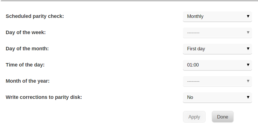

July 5, 20179 yr Community Expert 1 hour ago, TODDLT said: Did the scheduled parity check automatically update the parity or just flag the errors? Depends on if it's non correct or correct. For the rest you're making questions that it's impossible to answer without at least seeing the diags from when the errors happened.
July 5, 20179 yr Author 2 minutes ago, johnnie.black said: Depends on if it's non correct or correct. For the rest you're making questions that it's impossible to answer without at least seeing the diags from when the errors happened. Yes pretty irritated with myself for not thinking to pull diagnostics before the reboot. Last night I copied over the files which had been added to the array since my last backup ran, over into the backup system. At this point if there is anything not in the backup, its minor and I'm not overly concerned about it. I'm going to look at lunch and see if the scheduled parity is correcting or not. I think not.
July 5, 20179 yr Author 3 hours ago, johnnie.black said: Depends on if it's non correct or correct. For the rest you're making questions that it's impossible to answer without at least seeing the diags from when the errors happened. I checked at lunch and was correct the monthly parity check is non-correcting. I guess I have two options: Restore the disk from the parity which would reflect everything on the drive up until sometime when it failed, presumably yesterday. The wild card here is I don't know what caused those 5 errors, if it is something on the SSD or how it might affect the restored data. I can copy back over literally 98% or more of what is on that SSD using the backups that I have. Being the copy over would only overwrite the files it has, this would substantially reduce the scope of what could potentially be corrupted to the files added since the last backup last month (not much has changed since then Use process outlined above by itimpi to trust the data on the SSD and re-create the parity. I have the same ability to copy over from the backup once the parity is complete. The potential benefit here is if the 5 parity errors were due to something on the SSD, then in the copy over, hopefully it would be corrected or at least narrow the scope of a possible problem to a smaller group of files. Any thoughts on one option over the other?
July 5, 20179 yr Community Expert Difficult to say which option is better, if you had cheksums you could just scrub/check the emulated disk and it would be an easy answer. If you have a spare SSD (or HDD) you could rebuild to that and then use a file binary compare utility to find any different files, all equal files would be OK for sure.
July 5, 20179 yr Author 16 minutes ago, johnnie.black said: Difficult to say which option is better, if you had cheksums you could just scrub/check the emulated disk and it would be an easy answer. If you have a spare SSD (or HDD) you could rebuild to that and then use a file binary compare utility to find any different files, all equal files would be OK for sure. I might have a way to do that. I have an old 2 TB drive I had taken out of service but it was still functional. Is there a way to roll the 2TB back to a 500 GB to swap it back later? I think I'd have to go through a lot of gyrations to pull that off. IE copy everything off the drive, remove it from the pool, recreate the parity with one less drive, then add it back in at 500 GB? As another option is there a way to mount that drive outside of the array to do the comparison? If you have any suggestions for a utility to compare files at a binary level, please let me know. I'll see what I can do on another 500 GB hard drive. thanks again for all the help and time.

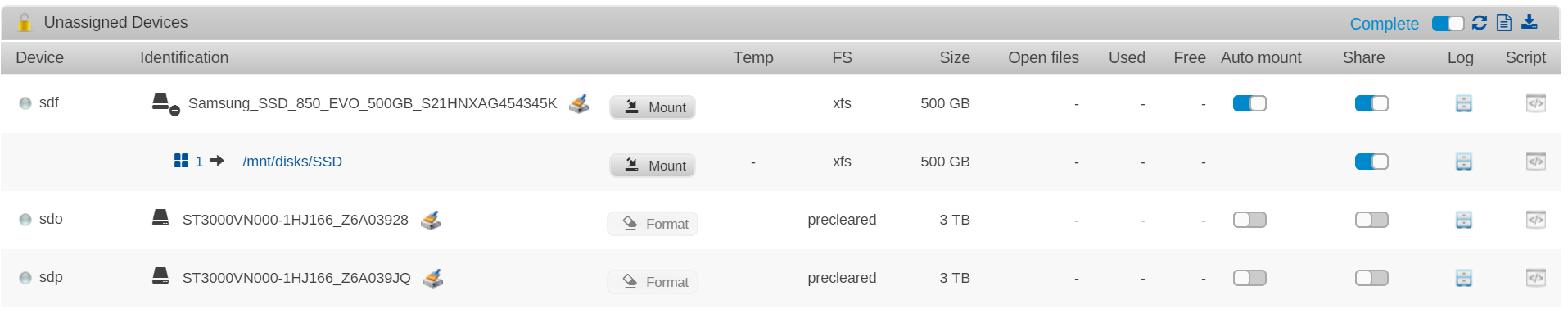

July 5, 20179 yr Community Expert 6 minutes ago, TODDLT said: Is there a way to roll the 2TB back to a 500 GB to swap it back later? Yes, new config followed by a parity sync 7 minutes ago, TODDLT said: As another option is there a way to mount that drive outside of the array to do the comparison? Unassigned Devices plugin will do, you'll just need to change the UUID of one of them since they'll be equal and only one will mount like that. 8 minutes ago, TODDLT said: If you have any suggestions for a utility to compare files at a binary level, please let me know. Rsync on unRAID or Syncbackfree if you prefer to use a Windows util.

July 7, 20179 yr Author OK well this came from the UD Log: Jul 06 20:33:32 Disk with serial 'ST3000VN000-1HJ166_Z6A039JQ' is not set to auto mount and will not be mounted... Jul 06 20:33:32 Disk with serial 'ST3000VN000-1HJ166_Z6A03928' is not set to auto mount and will not be mounted... Jul 06 20:33:32 Adding disk '/dev/sdf1'... Jul 06 20:33:32 Mount drive command: /sbin/mount -t xfs -o rw,noatime,nodiratime,discard '/dev/sdf1' '/mnt/disks/SSD' Jul 06 20:33:32 Mount of '/dev/sdf1' failed. Error message: mount: wrong fs type, bad option, bad superblock on /dev/sdf1, missing codepage or helper program, or other error In some cases useful info is found in syslog - try dmesg | tail or so. Jul 06 20:33:32 Partition 'Samsung SSD 850 EVO 500GB S21HNXAG454345K' could not be mounted, aborting... Jul 06 21:39:58 Adding disk '/dev/sdf1'... Jul 06 21:39:58 Mount drive command: /sbin/mount -t xfs -o rw,noatime,nodiratime,discard '/dev/sdf1' '/mnt/disks/SSD' Jul 06 21:39:58 Mount of '/dev/sdf1' failed. Error message: mount: wrong fs type, bad option, bad superblock on /dev/sdf1, missing codepage or helper program, or other error In some cases useful info is found in syslog - try dmesg | tail or so. Jul 06 21:39:58 Partition 'Samsung SSD 850 EVO 500GB S21HNXAG454345K' could not be mounted, aborting...

July 7, 20179 yr Community Expert 5 hours ago, TODDLT said: What would a "bit level difference" show up as? Any file with same name and a different modified time/date stamp or size will appear as different, bit level difference is any file with the same name and size but a different checksum. 3 hours ago, TODDLT said: Mount of '/dev/sdf1' failed. Error message: mount: wrong fs type, bad option, bad superblock on /dev/sdf1, missing codepage or helper program, or other error Post the syslog after an attempted mount but like I posted earlier you'll need to change the UUID so it's different from the rebuilt disk or you won't be able to mount both at the same time.
July 7, 20179 yr Author 18 minutes ago, johnnie.black said: Post the syslog after an attempted mount but like I posted earlier you'll need to change the UUID so it's different from the rebuilt disk or you won't be able to mount both at the same time. Sorry, I didn't catch that. How do you change the UUID? The errors I posted were form the Unassigned Devices log after an attempted mount. I have attached the full diagnostics zip taken at the same time. Your time is much appreciated. I'm learning as I go. todd-svr-diagnostics-20170706-2252.zip Edited July 7, 20179 yr by TODDLT
