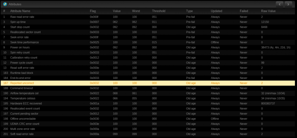

Hi, I had a power outage and the unraid server had an unclean shutdown.
After parity check on start up, I received the message:
Event: unRAID array errors
Subject: Warning [SERVER] - array has errors
Description: Array has 1 disk with read errors
Importance: warning
The SMART short self test is attached. Your advice please!
My guess is that it is a small thing. Stop the array; start the array in maintenance mode. Then go each drive, run file system check. Ideally nothing should be wrong. Then stop array once more' and reboot it. When back, run another parity test and it should show clear.
To increase the chances of getting help always post the diagnostics: Tools -> Diagnostics
hernandito, thanks for your reply. I have done as you suggest and the new parity test passed with no errors
johnnie.black, thanks I I will remember this for next time.
Thanks all.
