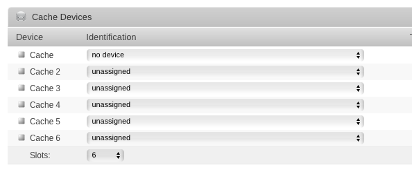

I can't stop my array at the moment to create a screenshot, but if the array is stopped, on the Main tab, in the Cache Devices section, to the right of device Cache under the identification column should be a drop down of available devices that you can assign to that slot.  If you don't see it, perhaps post a screen shot of what you do see in the Cache Devices section with the array stopped.
Here's what it should look like:
Thanks, tdallen...This is what I found on mine.
I'm wondering now if I have a wiring or hardware issue like you previously mentioned.  It doesn't appear that it sees any devices that could be assigned to my cache.

If you are clicking on the arrows to the right of "no device" and there's nothing available to assign, then it sounds like a hardware issue.  Check cables and try another SATA port if you can.  Unfortunately this seems to explain what happened to the original spinner.
I give up!  I have a SATA II card plugged into PCI EI slot on my mother board.  There are two slots on the board...I tried both slots to no avail.  I moved the  cache drive cord to a vacant regular SATA slot, and again, no change.  The only thing I haven't changed is the cord.  I need to dig one up in storage and try it.  If that doesn't work it's got to be something in programming which is way beyond my paygrade?
