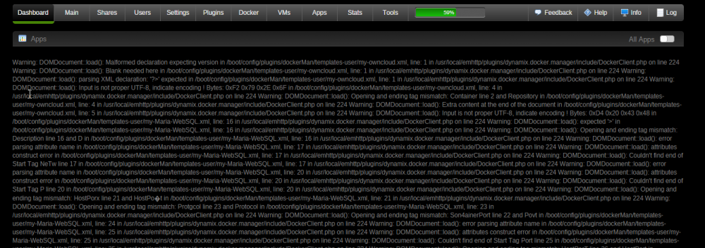

After updating to 6.3.5, all the PlugIns (6.3.2) and changing some array drives, I receive some strange errors.
This occurs in Dashboard, Docker and Community apps. Can you help me, what went wrong and how to fix it again?
Thanks!

The files within the folder config/plugins/dockerMan/templates-user on the flash drive are all trashed.  No idea why though.  An update won't affect any of that.  Toss the flash drive into a desktop and check the file system on it.
If that doesn't get you anywhere, then you should delete that folder, and you should be good to go (somewhat).  You're eventually going to have to basically delete your docker.img file and re-add all of the applications again (and re-setup all of the volume mappings that you've had), otherwise certain features of the docker tab aren't going to work properly.
