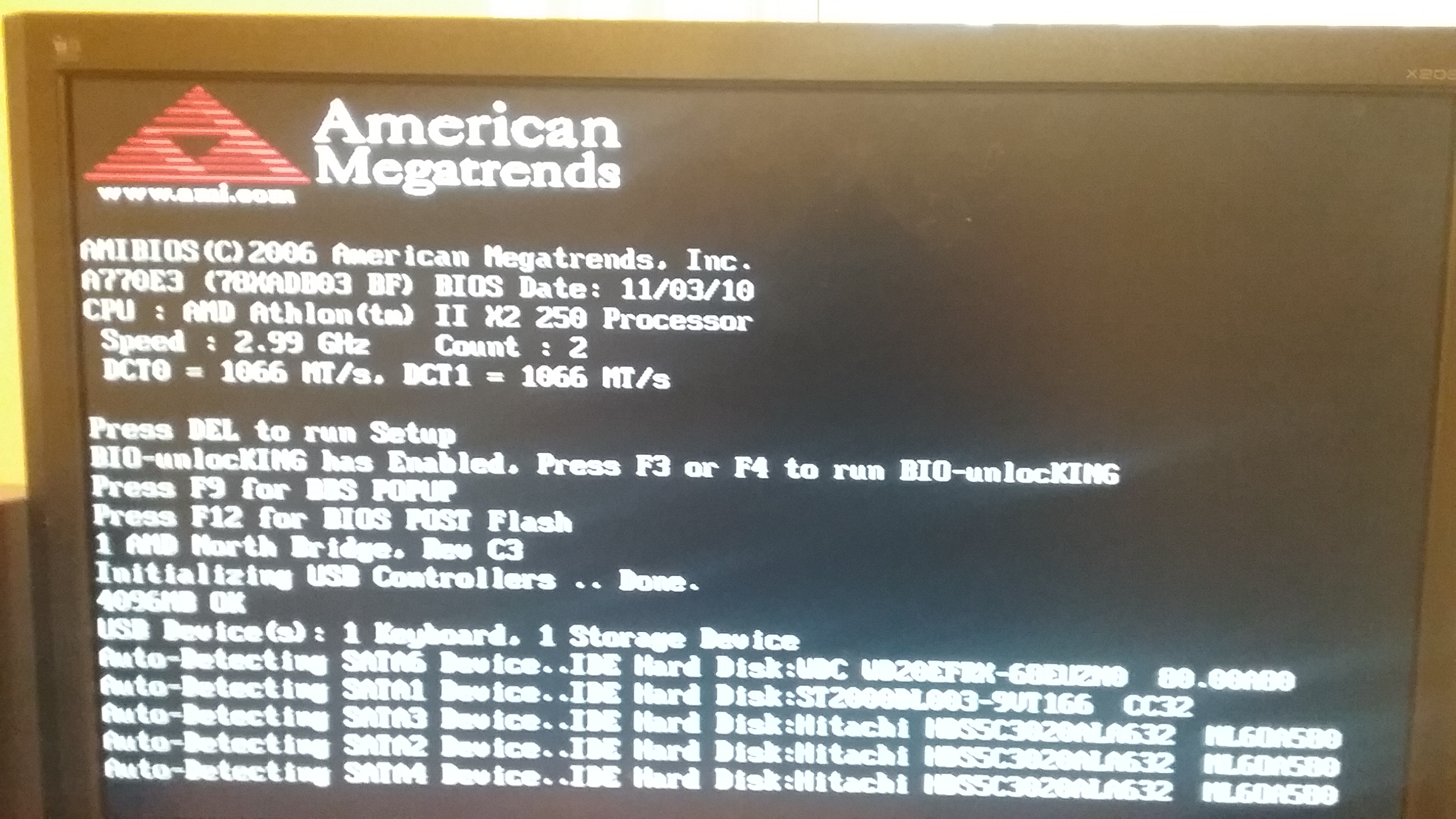

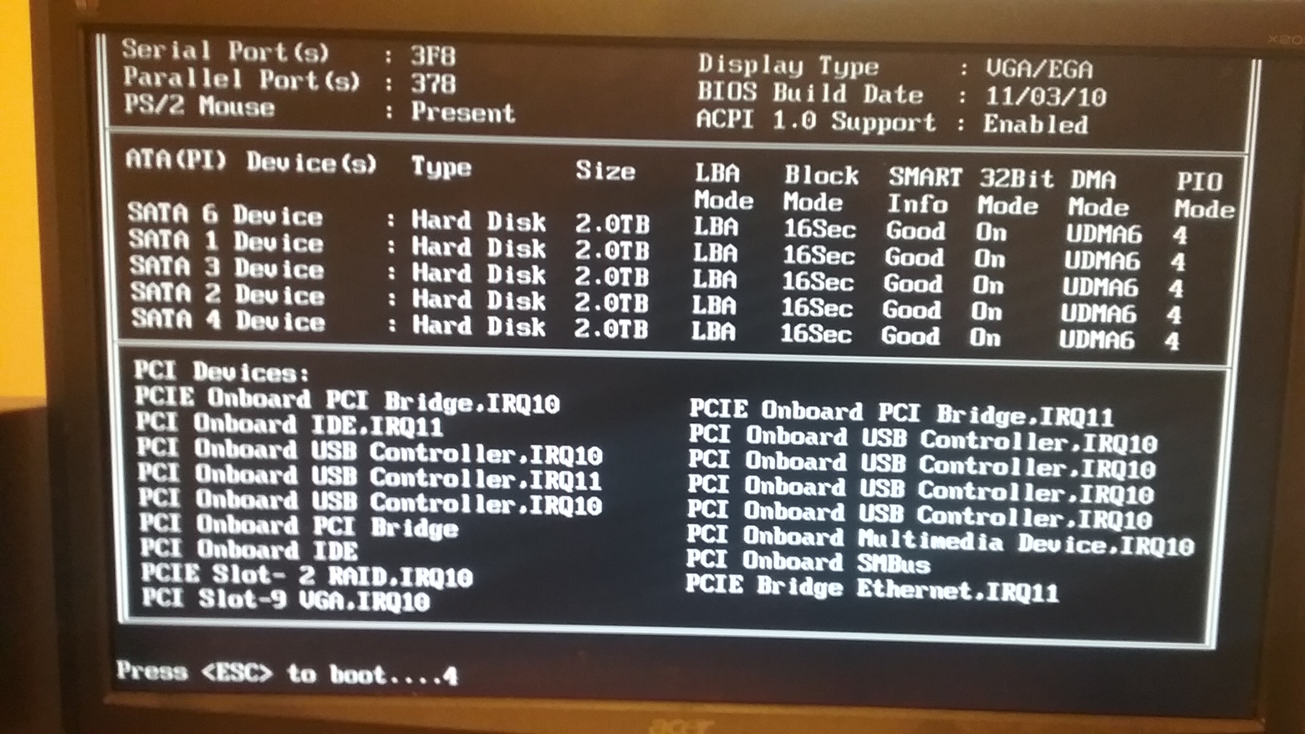

You mentioned the POST screen. This is what I got. Not sure what to look for.
