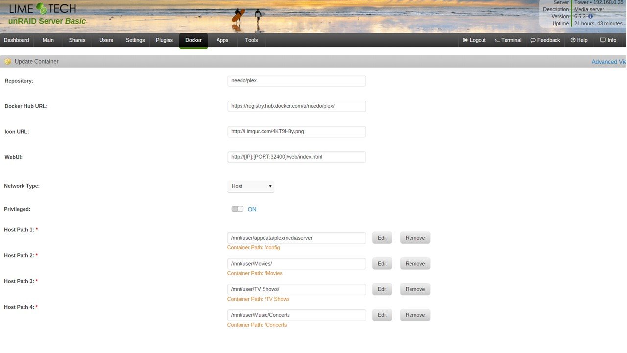

I have 2 Questions if you'd be so kind:
  • What is the process for changing my Plex docker to a new repository?   I'm attaching my current settings and mappings.
  • Would my appdata files sitting on my cache need to be updated or can they be used as they are?
Thanks!

It would *probably* work if you just make a note of all the paths (host and container) (ie: /mnt/user/appdata/plexmediaserver -> /config) then stop Plex, install binhex or lsio flavours and set up those same paths in their template
Thanks Squid but what is the process to install the new repository? Stop the current PlexMediaServer container, then create a new container with the binhex Plexpass? Is there step-by-step documentation somewhere?
So theoretically I could keep the old Plex container (stopped) just in case something doesn't work with the new one?
Stop the container, from Apps install the binhex / linuxserver version then on the template, add in / adjust all the path mappings.
Alternatively, change the "repository" line on the existing container to be linuxserver/plex when you edit it.
Just FYI.  I will say that when I attempted something like this, it did not preserve my existing Plex state.  I may have done something wrong - I stopped my existing docker, installed the new one, pointed it at all the same locations.
The new instance did not preserve all the prior configuration, so none of the viewing history or date added was preserved.
Just FYI. Many people have done it, including me, and it worked fine. Just make a backup of your plex appdata if you want. Then

As I understand it, even if we preserve the path mappings exactly the same in a new container we may lose a bunch of metadata?  So it may be better to keep the same container and just replace the Repository entry? How about the Docker Hub URL?  And also the entries in Template Repositories field?
Has anyone migrated from Needo Plex docker to a more current one like linuxserver's can you please chime in?  Thanks!
The metadata is in your plex appdata so no reason you should lose anything if you keep the appdata mapping the same. You must also keep the mappings to your media the same so the paths match what is already in your appdata.
