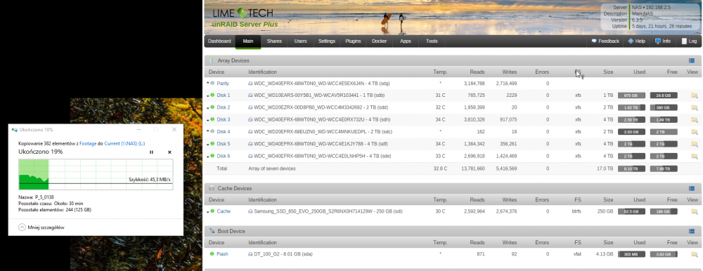

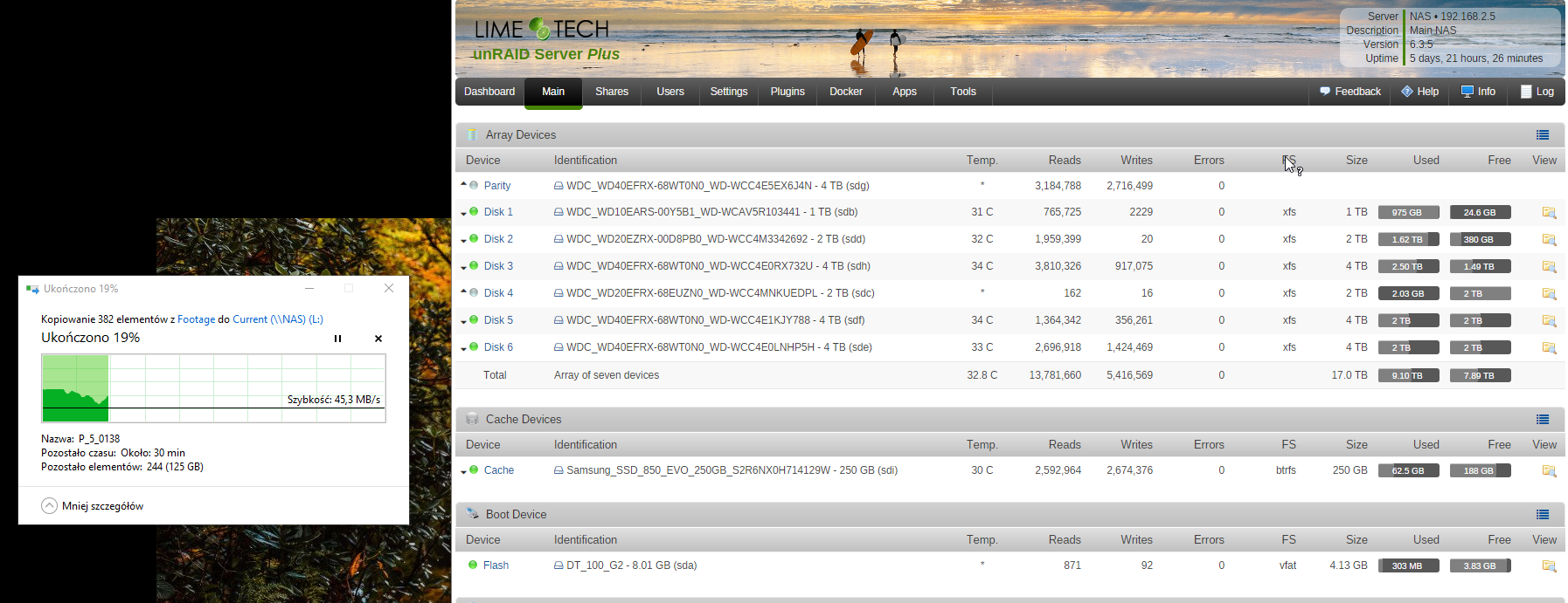

It's not as bad now as it was 2 days ago, but speed is going down from time to time (before it was mostly 20-40MB/s) and the Dashboard loaded faster although noticably slower than just few minutes ago before I started copying.
