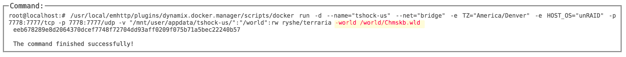

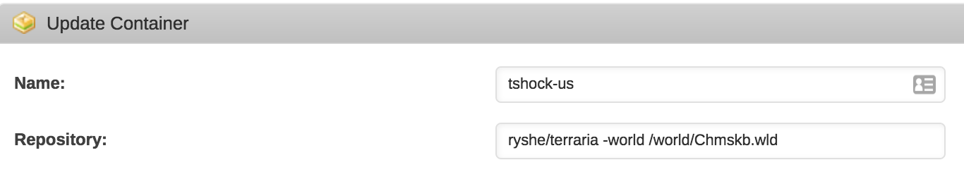

Currently the docker UI in unraid is quite complete but it is currently missing the ability to add "commands/args" to the end of the docker run command.
There is a work around by putting this info in "Repository" field of the UI but this breaks the update functionality.
So it would be great if this could be added to the UI as another field so everything works correctly. :D
For more info you can look here

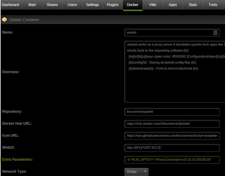

I might be wrong, but isn't that what the "Extra Parameters" is for(under "Advanced View" in the top right when editing docker settings)?
You would think that, but it puts the parameters in the wrong order in the run command.
The extra parameters field is used for extra parameters to the docker RUN command, and places them before the repository.  Any extra parameters to the container itself can't be used here and for the time being have to be added to the repository entry which then messes up checking for updates
