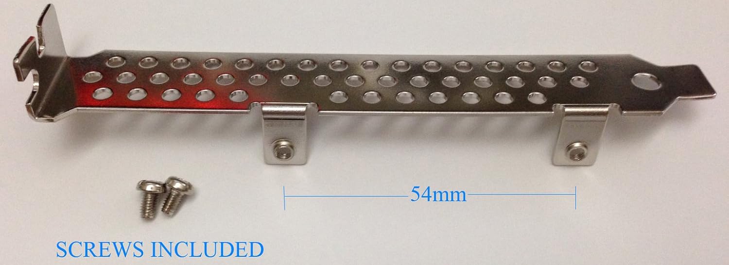

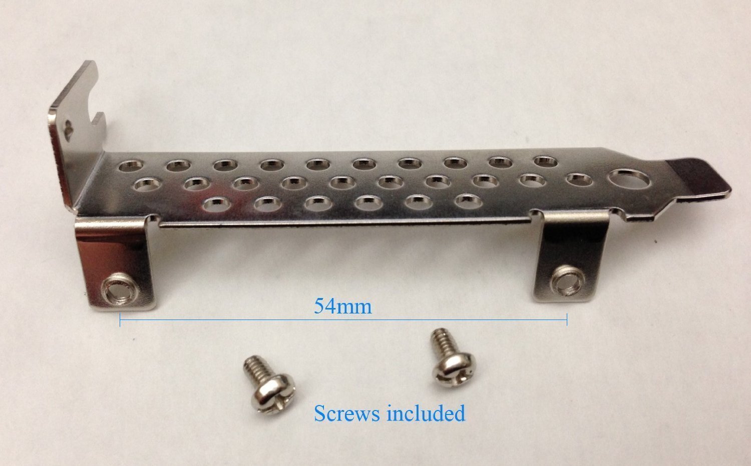

July 14, 20179 yr Author 36 minutes ago, bjp999 said: They are basically the same. But the 9201 is a pure HBA, not a RAID card. No flashing necessary (although can be flashed to latest version if desired). The 9211 is a RAID card that needs to be flashed into IT mode to make it work as an HBA in unRAID. Both are PCIe 2.0 x8 cards. Perfect 9201 it is. thanks for that. I don't supposed you know if this is the correct screw spacing for a full height bracket on a 9201 card? All of the 9201's I see come low profile. http://www.ebay.com/itm/Standard-Long-Bracket-Dell-Boardcom-PCI-E-Gigabit-Network-Adapter-R900/322180272734?ssPageName=STRK%3AMEBIDX%3AIT&_trksid=p2060353.m1438.l2649
July 14, 20179 yr Sorry, don't know. I have the 9201-16i which is a full height card. Works great! Not sure why so pricey, but I needed the 16 ports on the single card and bit the bullet. The 9201-16e is cheap as dirt. If you feel like routing the cables from outside the case inside, it is a heck of a deal! But I like the locking mechanism on the SFF-8088 much better than SFF-8087, which always seems to be trouble to get to lock into place. The 8088's are better!
