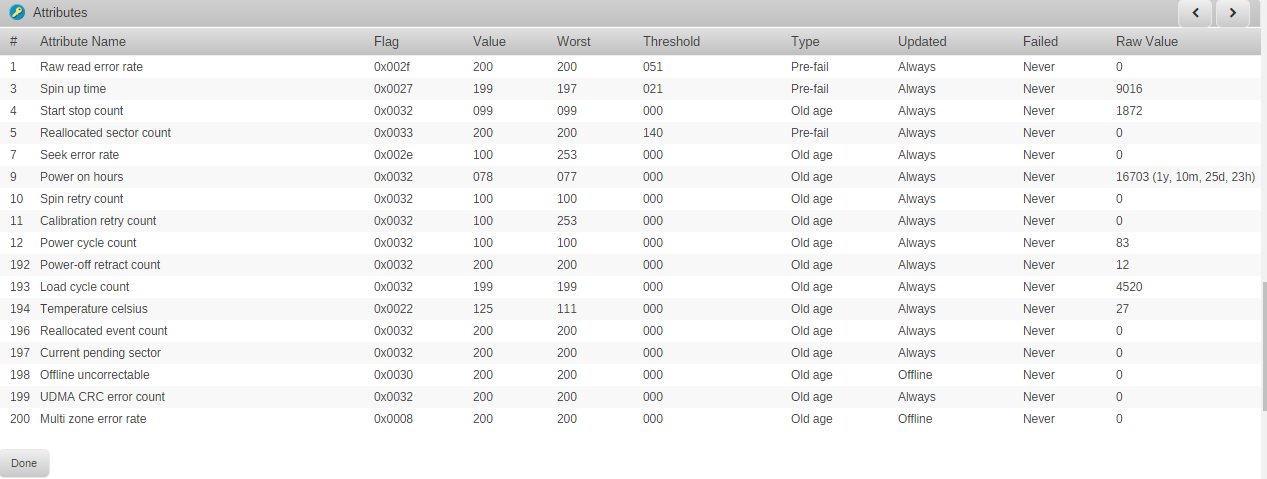

I have attached a SMART report that I hope someone can take a look to make sure I am not missing any errors.

If they are all like this, you are good to go.  You are basically looking for Attributes #5, 196, 197, 198, and 199 to be all zeros.  (IF they are not, ask back as some of these, in some cases, can be non-zero and the drive still be good.  Also, #199 is not a disk error per se but is usually an indicator of a cabling or controller issue.)
Thank you Frank1940, they are all like the above.  Now I just have to wait on my power cable order since I didn't realize I was out of Sata power connectors.  Then I can start replacing the drive and adding new ones to the array.
