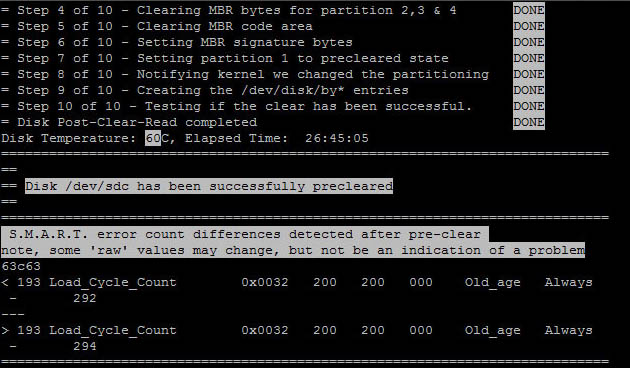

Here's a screen shot from one of the drives after the pre-clear.
I really doubt it's a hard drive issue, what can go wrong with the network that might cause this?
Precleared my 2 x 1.5TB drives, remounted, reformated, same thing...
What are you seeing in that screen shot that looks wrong to you.
All I see is that the disk heads were loaded twice onto the platters during the course of the pre-clearing operation.  It would have been an issue if the heads were not loaded onto the disk platters.
Joe L.
Yes I'm saying that there doesn't look like there's any problems with the hard drive.
Thus what else could be causing my problems. Even trying to open a JPEG file from the server jams it up.
Actually, looking closer, I see a disk temperature of 60C.
That is blistering hot.  (60 degrees Celsius = 140 degrees Fahrenheit)

Hm... yeah, things do get a little hot here in Singapore, 60deg was at full load on the drive, ambient runs around 40
At full load you should be looking to keep the drive no higher than 50C and preferably no higher than 45C.
When i am doing a full parity check the hottest one of my drives gets is around 44C. Get some cooling in there or you will kill the drive ina  very short amount of time.

Also, I've replaced the slower chassis fan and added another one to further cool the system, thanks for the tip! (Drives now run at just over 40deg at full load)
