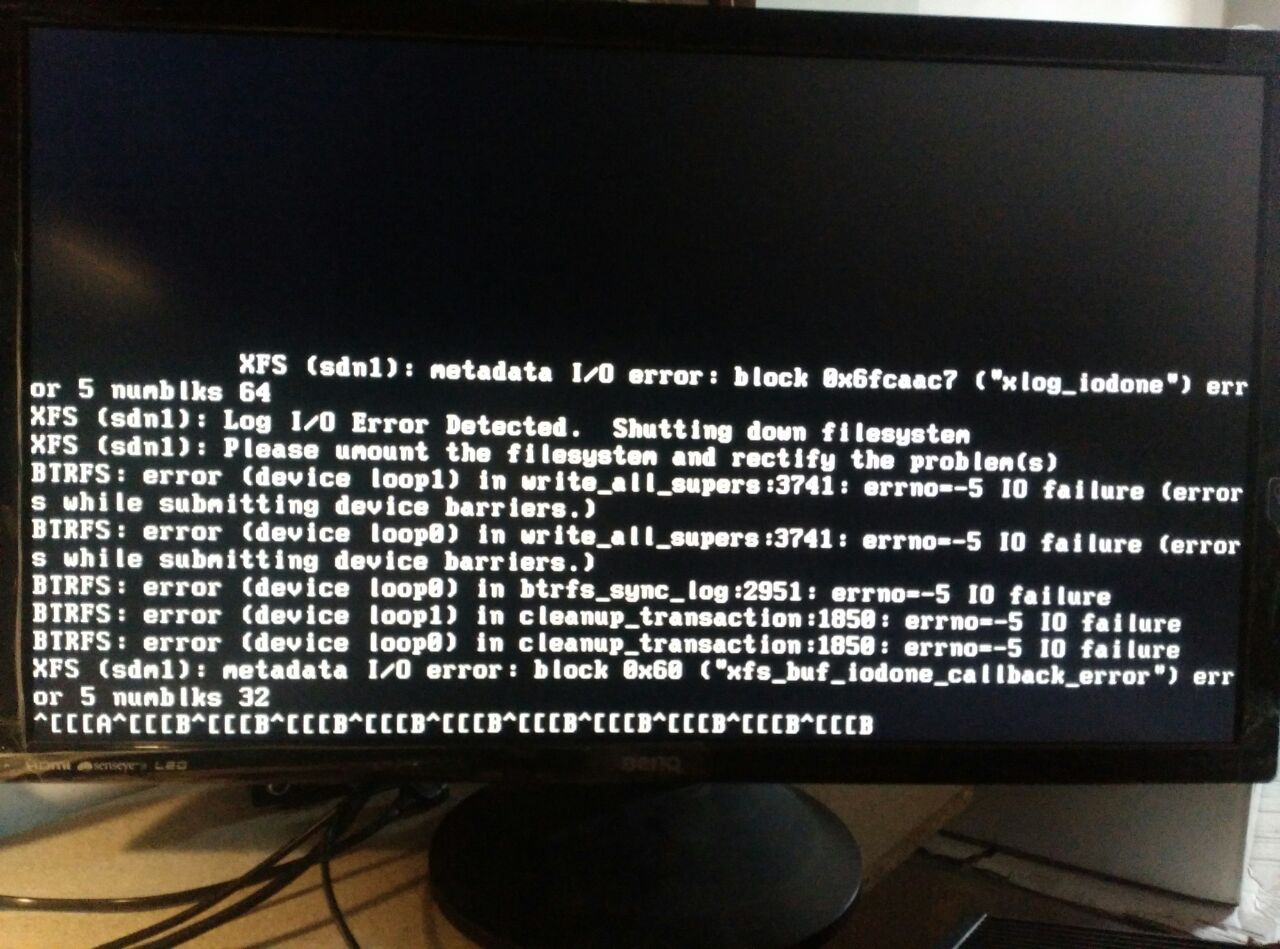

Hi, I am getting this error and really have no clue what can be causing it. I cannot start my windows vm. Everytime I start my vm this error shows up and unraid freezes forcing me to do an unclean poweroff.
I thought it could be my cache ssd where the raw vdisk is. So I installed a new ssd mounted using unassigned devices, but same error shows up.

Filesystem corruption on both your unassigned device and the docker image on your cache device, maybe worth running memtest to rule out RAM issues, if no errors run xfs_repair on the unassigned device and delete and recreate your docker image.
After doing this I still get the same error.

I just reformatted the cache drive in xfs (before it was btrfs) and now the same vdisk works. I guess the error was produced by btrfs!
Just wanted to post it in case someone goes through the same issue.
Rgds.
Too early to say it works. Again -after reboot- I have the same error.

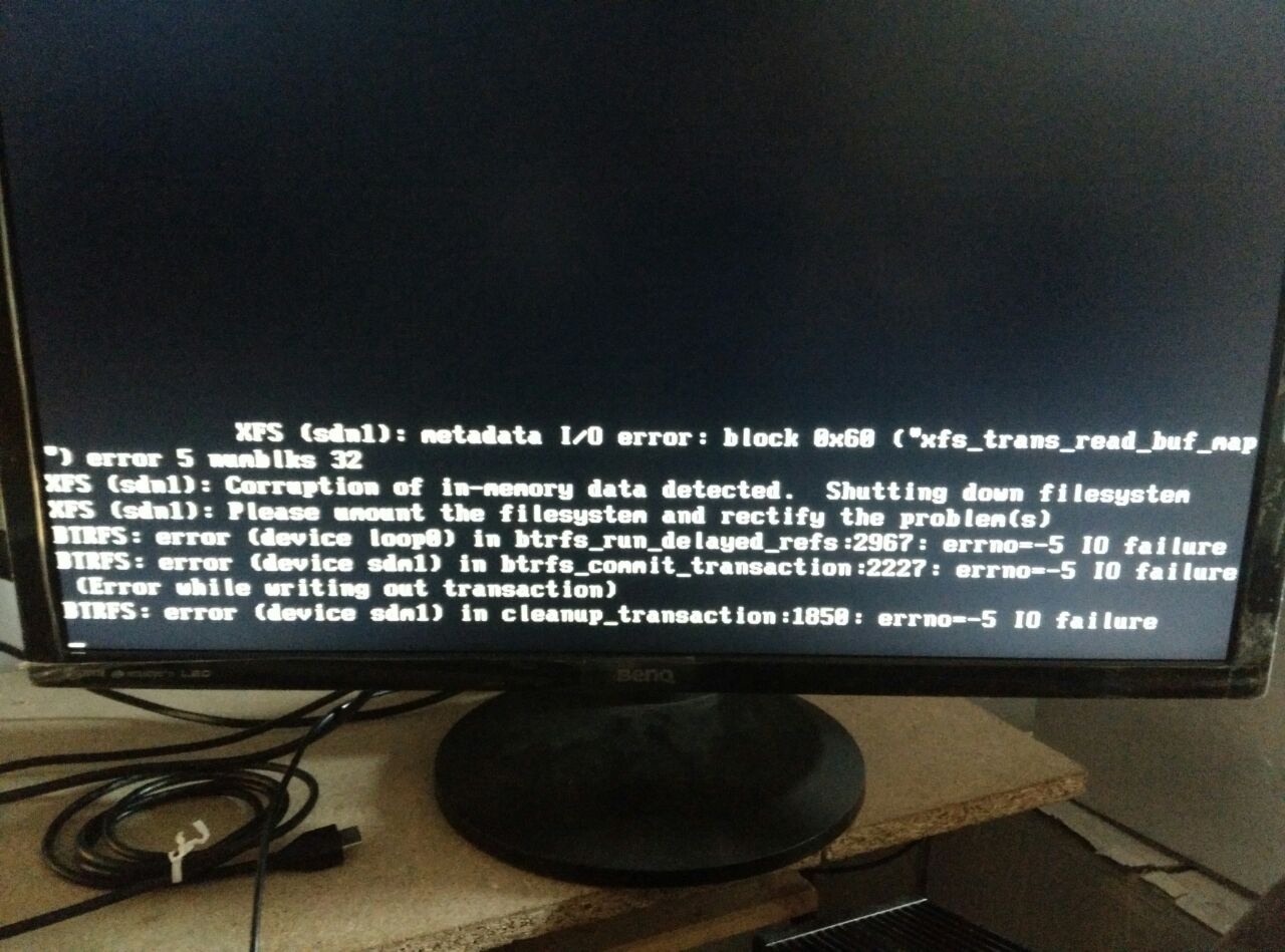

Now I also tried another SSD formatted as XFS. And I did not use cache at all, only this SSD mounted using Unassigned Devices (UD). I did another 2 hours run of memtest with no errors. Docker (krusader) and VM (libvirt) where placed on the mounted SSD in UD. Docker and libvirt images were created new.
My screenshot shows the error.
I am not a linux expert so I can´t interpret this error.
Any ideas how to proceed?
Really don´t want to go the fresh Unraid install route, since now I am not sure if it is a hardware error or a pure software error. It only happens when starting the vm!
Any help is appreciated.

Its going to be hardware related.  Whether that's due to bad ssd's, controller, cabling, or power is hard to say without a new set of diagnostics.
Because the system is unable to read the SSD at the sectors containing the libvirt.img.  (And according to the screenshot, errors are also present on the docker.img file)

Ok, after 5 days working on my server I discovered the problem is caused when I plug a new USB hub I recently bought.
