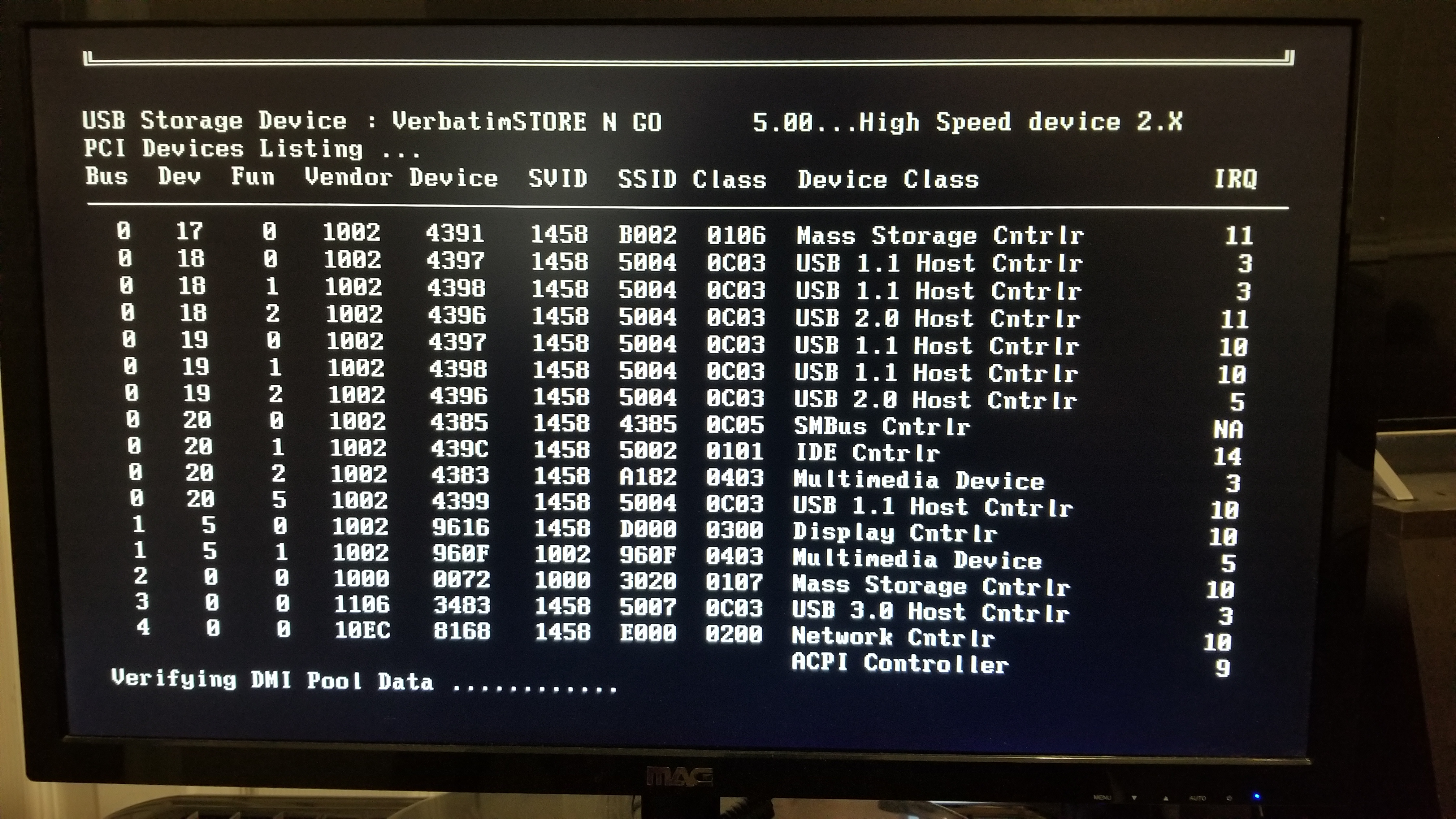

So I successfully installed the new drive controller (thank you Amazon One Day shipping) and flashed it to IT (not as hard as I thought). But now Unraid hangs during boot at "Verifying DMI Pool Data". Any more guidance?
10 minutes ago, Squid said:
Recheck your boot order
My boot order was correct. USB-HDD > USB-FDD > USB-ZIP. It booted properly as long as no drives are connected to the controller. It also booted if I only have drives connected to the motherboard. I had to go into the controller settings and set it to OS-Only mode so it would boot. It looks like the controller messes with the boot order somehow. Fortunately it's all working now. All of my drives are detected. I can also stop docker containers, stop the array and power the server off. My speeds also appear to be back to normal. Unfortunately, it looks like there was some data loss from this whole thing. Some of my TV show files aren't playing in Plex. I'll have to work on that.
