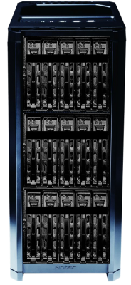

I would very strongly recommend a case that would enable you to use hot-swap style drive cages. Our #1 NAS issue is people knocking cables loose while adding or exchanging disks, and although this case is better than some, it does not allow swapping disks without touching the drive wires, which are incredibly easy to knock slightly askew. And that's all it takes to create an intermittent issue that leads to drives being dropped from your array, and a ruined Sat afternoon trying to get it sorted out (and sometimes lead to data loss).
Drive cages, like the SuperMicro CSE-M35T-1B, are installed in the case once, and the cables are never touched again. Adding or exchanging disks becomes incredibly easy. I'd recommend these above dual parity, which like @tdallen mentions are more appropriate for arrays with larger drive counts. In fact, the main value of dual parity in a small array is to help recover (sometimes anyway) when a cable IS knocked loose, while these cages virtually eliminate these problems from happening in the first place!
A case like the Antec 900 would hold three of those cages and give you 15 hot-swap drive slots (see below). The one I mentioned can sometimes be found on eBay for between $55 and $70 delivered.
Hmm, that's a good point that I hadn't thought of, I was pretty much focused on finding a reasonably priced case that could hold all of the drives, but hadn't taken into account the disk swap issue.
Thanks for highlighting that and the case recommendation, I'll do some more delving into some case options before I pull the trigger.
