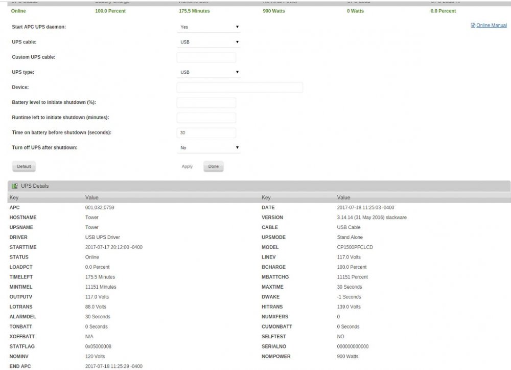

So I'm using a CyberPower CP1500PFCLCD as a UPS for my UnRAID server.  Lately, I've had two power failures that resulted in unclean shutdowns and a subsequent parity check upon reboot.  I can't figure out how to see the syslog for before the shutdown occurred?  Is this available somewhere as I checked my log folder on my flash drive and I don't see anything?  My guess is the server shutdown immediately on power loss but no way to confirm without manually pulling the plug to the UPS (which I'd like to avoid  if at all possible).
After the first failure, I changed my UPS settings to initiate a powerdown after 30 seconds.  Previously, I had it set to shutdown with 10% power remaining.  The UPS is relatively new so it's not like the battery is bad.  My dashboard shows the UPS is connected and I've attached a screenshot of my settings page.  Feels like something isn't configured correctly?  Any suggestions appreciated.

I looked at your UPS settings page (in your first post) and noticed that the "UPS Load and UPS Load %  readings were both zero.  Are you sure that you have pluged the server into a battery protected outlet on the UPS?  (I know this is like a customer service representative asking if a dead computer is plugged into the wall outlet but there is always a reason to this sort of question!)
Good catch. Hard for the UPS to calculate things properly if the load isn't being sensed. Maybe a defective UPS?
Yep...that would be the problem! Nice catch. I can't even venture a guess as to when/how that hapepened! Nevermind the obvious cues from the dashboard (missing load info and 175.5 min of runtime!).  Anyway, thanks for endulging my stupidity!
