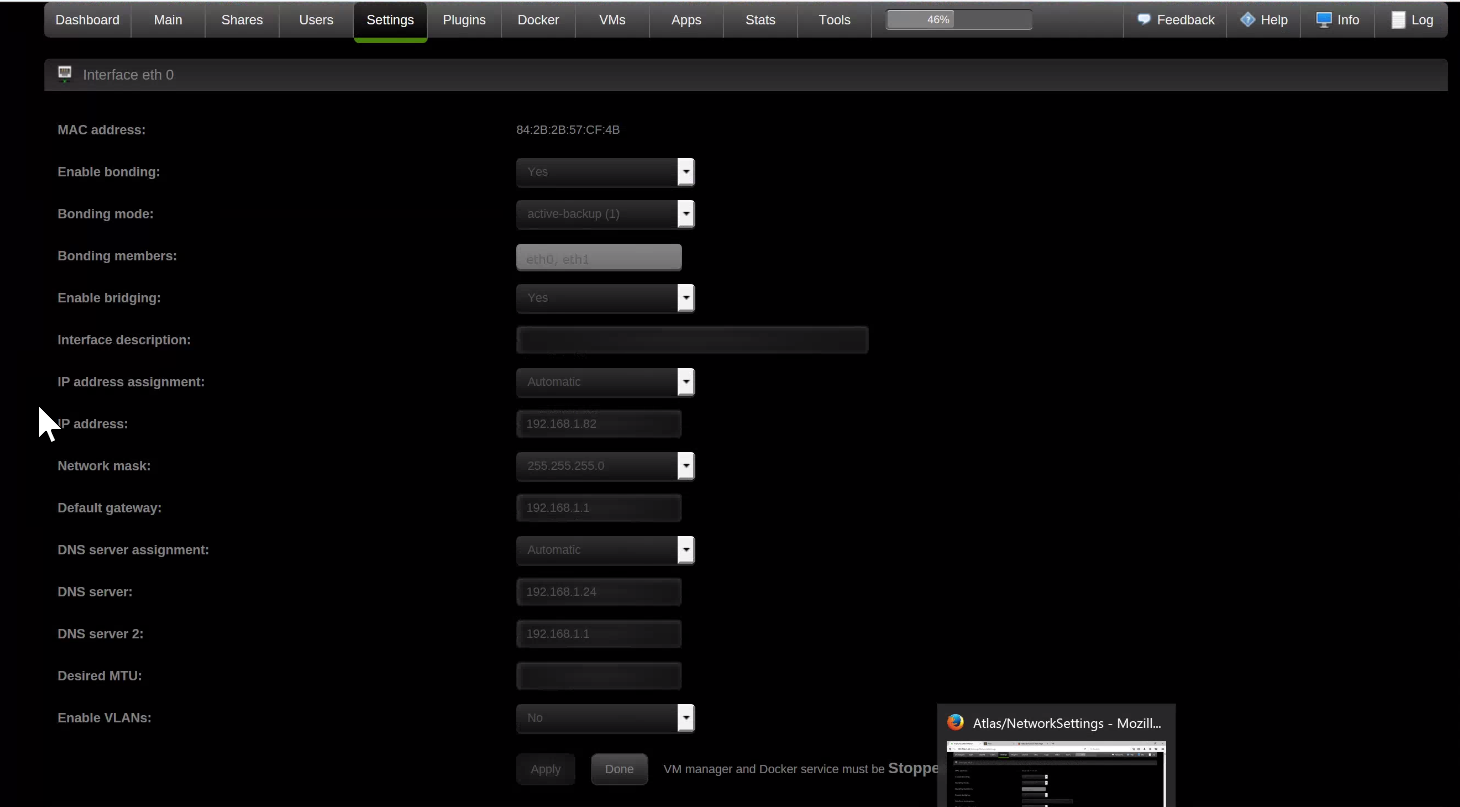

I'm trying to get KVM working for the first time and seem to have run into a snag where the vm's dont get a ip address from the br0 network (bridged mode). This happens on Windows VM's and linux vm's  (ive tried 3x now) as well as vm's that were imported form vmware.....
I should mention here that i have installed the drivers for the hardware
Here is a sample of a kvm xml file, and a screenshot of my network settings, as always thanks for anyhelp

Yup sure did, this is the thing i was troubleshooting on my own when i wrecked my network :) thanks for that again btw
I think i may have it, i had my network set to bond both of my nics with one being a backup the other the primary.... removed the bond and were good not i suspect thats not the correct behavior though
It should work with both bonding enabled or disabled. The key is to have bridging enabled and use 'br0' for the VM.
If you use just a single interface then bonding is not really needed.
