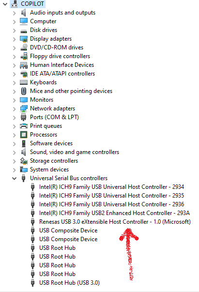

StarTech PEXUSB3S44V with four Renesas µPD720202 Controllers - Latest Firmware dated to 2012
IOMMU Splits up OK with ACS Override and VFIO blacklisting.
Passes through to VMs OK, being seen in the OS.
Windows: Throws a Code 10 error, device cannot start directly on hub. Startech drivers and Microsoft xHCI drivers both do not work.
Ubuntu: Does not work at all, presumably due to same issue the windows VM was seeing.
ESXI/Windows: Seems to work identically to the IFC-PCIE2U3, in that everything functions both in and outside the VMs and between shut-downs and reboots. This is where I think there should be hope for the StarTech card with unRAID/KVM with some discrete setting, or as seen in the last link below, a kernel supporting USB Attached SCSI.

    IT WORKS!!!!!!!!   The main difference: The PCI bridge in this card.   1c:00.0 PCI bridge: ASMedia Technology Inc. Device 1806 (rev 01) 1d:00.0 PCI bridge: ASMedia Technology Inc

Unfortunately I didn't see this thread until after I ordered the Startech card.  I was thinking since it has a perhaps more robust power source via molex connector it may work better in my case.  I've run into the same as the others with it looking like it should work but the errors in Windows and non-functionality are present.   For fun I tried in another PC and works fine in bare metal Windows.  As well I tired a very recent Openelec via a USB boot and the Startech card appears to work fine (sees a USB disk attached into Openelec bare metal).
So it looks like the Startech card can work in Linux too... Unraid just doesn't see it nor can it be passed to a VM.   I'm just not sure what to check or change in Unraid and would be open to any suggestions to try before I send the card back.

I decided to try the Sonnet Allegro Pro USB 3.0 PCIe card (USB3-PRO-4PM-E).  It has been flawless so far (2 weeks) with hubs plugged into 3 of the 4 ports and no issues with many USB devices passed to various VM's.  IOMMU split out without any extra settings or overrides on my EP2C606-4L server.
Edited by mikeg_321
clarified Allegro Pro as USB 3.0 & model number (the one I have functioning) - there is anew 3.1 card as well... I have not tried it
On 5/5/2018 at 3:31 PM, mikeg_321 said:
I decided to try the Allegro Pro USB 3 card.  It has been flawless so far (2 weeks) with hubs plugged into 3 of the 4 ports and no issues with many USB devices passed to various VM's.  IOMMU split out without any extra settings or overrides on my EP2C606-4L server.
Can't believe I'm going to spend $100 on a USB card, but sometimes 'just works' is worth the premium. Thanks for the update
Did you have to cut wires or do anything non-standard to use USB hubs with the Allegro Pro card? I haven't been able to get hubs to work with any of the cheaper USB cards I have.
Yeah, $100 for USB is nuts.  Think of it this way, it's actually 4 USB cards. which you can basically turn into 4 different computers via VM's  ?
I just looked and I have 2 non powered USB hubs that are working fine which didn't work on the other cards I had. They are out of the box with no mods. The other powered USB hub does appear to have a wire cut.  Suspect I cut +5v as it's powered and I was having back feed issues in the past.  My system is working so well I hate to play around and see if it would tolerate the back feeds or other hubs better or not though.
Another thing to note is that my bios has an ACS on/of option which I have enabled. That may have helped in splitting the addresses out to individual IOMMU's.  Point being, there's so much variability between systems I'd just say make sure you order from somewhere you can return the board in case you don't have the same luck I have.  Amazon was great when I had to return the Startech.

First post here on the forums, but with my long USB battle I wanted to post up my results.
I can 100% confirm that the Sonnet Allegro Pro card is the only one I have gotten to work on my X399/1920X build. I fumbled with the PEXUS Startech units and could pass them through to my VMs, but the drivers would either crash or the controller would fail to start correctly. They also had issues powering multiple HIDs when a hub was used.
I now have a dedicated controller passed to each of my three LAN gaming VMs with the Sonnet card. Each USB port has a hub plugged into the end to allow players to have their HIDs and their headsets connected. Audio is perfect and hot swap sure is nice to have now. Especially since a lot of the HIDs were of the same make/model and webGUI USB passthrough was very buggy for me.
