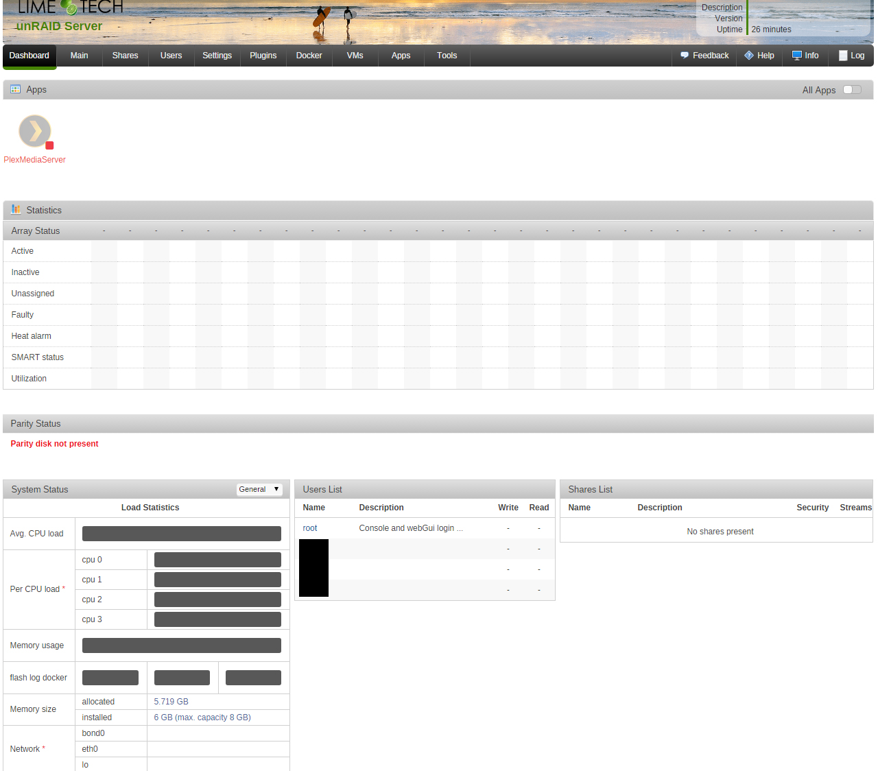

Hi all,
I have a bizarre issue where shortly after a reboot, all my disks go missing.  Both the Dashboard and Main tabs show nothing, and the Web GUI becomes unresponsive.  In fact, even the Description, Version, and Uptime fields at the top right are empty.  I can only restart the system via SSH, which seems to work properly.  If I try to run "diagnostics" from SSH, the resulting .zip file is blank.  This issue seems to occur between a couple of minutes and a couple of hours after a reboot, usually much closer to the former.  It happens even if I don't start up the array, or if I start up the array but don't mount the disks (via maintenance mode).  On reboot, the disks are all displayed properly and the Web GUI behaves as expected, until the issue suddenly occurs again.
Unfortunately, I can only provide my diagnostics from before the issue occurs.  I'm attaching a .zip from a couple of minutes after a reboot.  The disks went missing and the Web GUI became unresponsive shortly after I ran the diagnostics.
I am running Unraid version 6.3.5.  Any help would be very appreciated.  Thank you!

Put Fix Common Problems into troubleshooting mode, make note of what it says to do after the crash, then start the array and wait for the problem to happen.
Can you stop synctvshows.sh from running. It takes all communication ports.
Easiest is to start unRAID in safemode.
You were right.  I was using segmented downloading with lftp, the script was causing issues.
