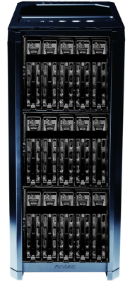

Many towers of that vintage support installing so called "5in3s" that allow 5 drives to be mounted in the space of 3 5.25" slots. I use CSE-M35T-1Bs in my servers, which are the best of the best IMO. Deals can occasionally be had on eBay, although these have been fewer of late. Here is a picture of an Antec 900 with 3 of those cages. Swapping drives is a breeze with virtually zero chance of creating a cabling event.
If that won't work or you have more drives than will fit, I have a couple of the cages that I keep outside the server. You could even screw a couple of those to support 2 or or 4 cages (5-20 drives). You just need something like an LSI SAS9201-16E, purchased from eBay for about $50, plus some SFF-8088 breakout cables. That would support 16 drives. For power I run a PSU pigtail out the back of the server and connect the cages (only one needed per cage, so very manageable). This would be cheaper than the units you are looking at, and probably faster too. Your PSU would power everything.
